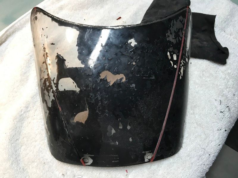

I need suggestions on saving this windshield. Hopefully someone else has been down this road.
Why ask why.
Obviously paint does not work on polycarbonate. I checked the manufacture on line but the manufacturing code did not show up.
Paintlite-sheet PC7112.
Researching the last couple of days for options. Usual scratches but has cloudy areas. I doubt the cloudinesss can be removed.
Polishing. Yea and nay. Mixed results. Cloudiness probably won't come out.
Vapor blasting. Hmmm, not sure of the process or results.
Painting.  Paint has come a long way however with plastics I have read where there is a constant release of manufacturing gases. Not sure if this goes away after 30 years.
RC polycarbonate paint. Well, that seems to work however modelers only paint the inside. This might hide some of the areas but not all. Painting both sides would probably not work but once again, not sure.
I have no other options as finding a replacement would be as rare as hens teeth. I have searches ongoing on fleabay.
So, I'm open to your thoughts, suggestions, recommendations.
I did get the paint off using hot water, dish soap, damp t-shirt. It took a while too!
TIA

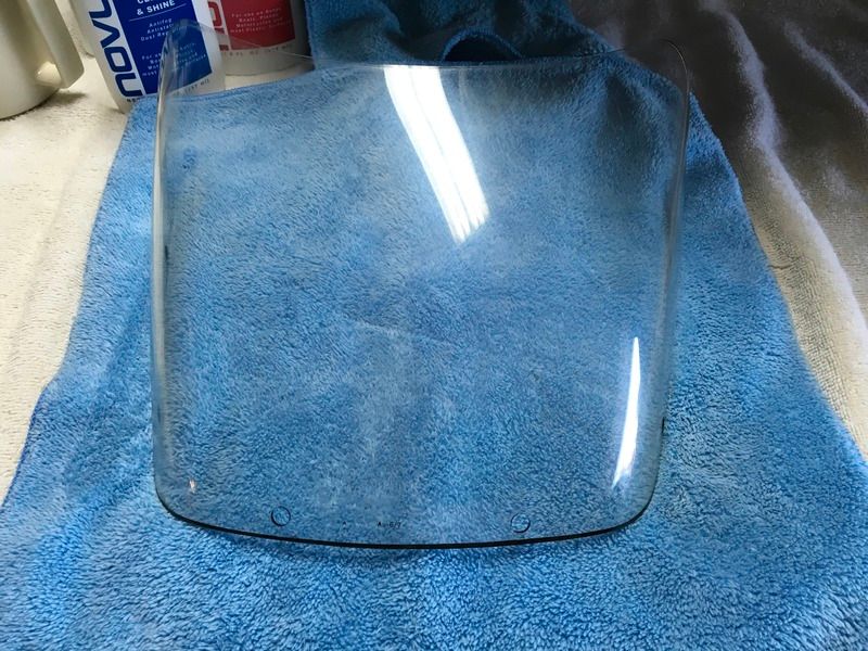

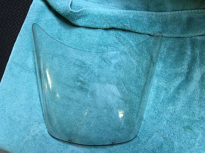

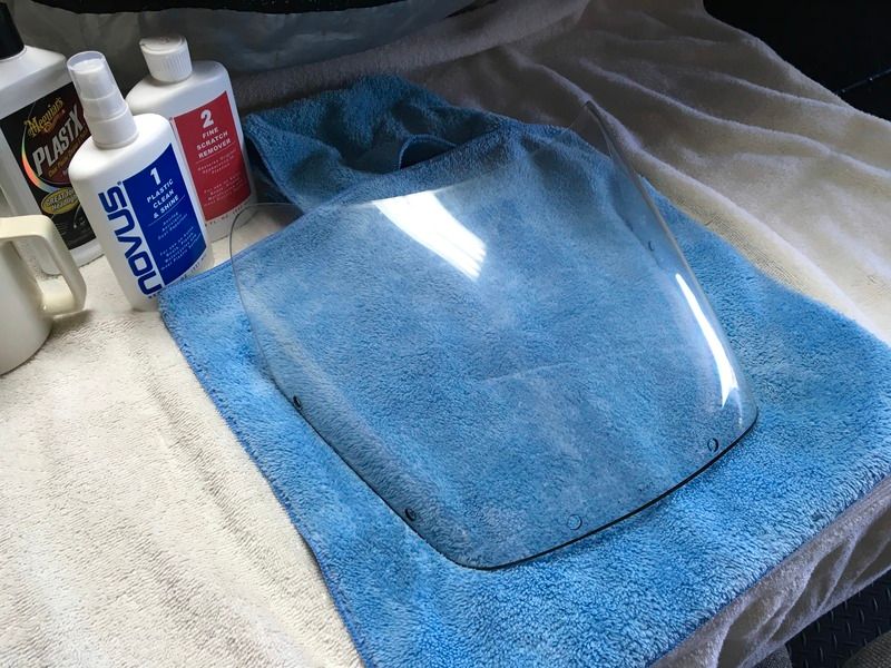

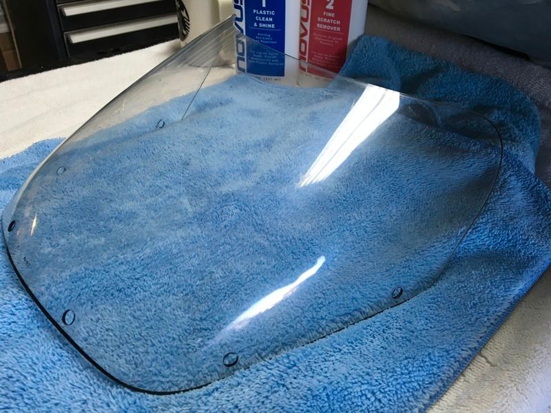

Although pictures won't show everything here is the progress so far.
Morning sun.
I think this is as far as I can get it at this time.

Yeah, I think it is not possible to restore it completely.  If some company would make new ones from yours, that would be ideal.  I have a screen for the cx500 only on the european models, made the bike's maggot cowl on the 78-79 std bikes actually look presentable.  The european cx500 kept the cowl with screen for many more years.  Mine is smoked plastic and it has crazing all over inside, It came from the UK and is now 3rd hand.  Since I won't be looking through it that issue does not bother me...just serves to redirect some of the wind.
I am sure there are some members who speak German on the site.  You can use Google Translate if you want to grab descriptions and paste it into their tool.  Some web pages translate ok with feeding it a url, others heavily built with frames do not.
There is a sohc4 member with a cx500 turbo that is a US serviceman in Germany...maybe he could assist you...or point you to some additional help.
