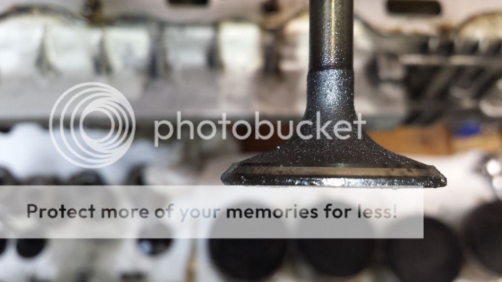

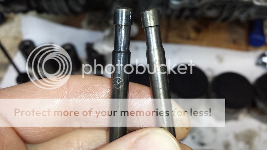

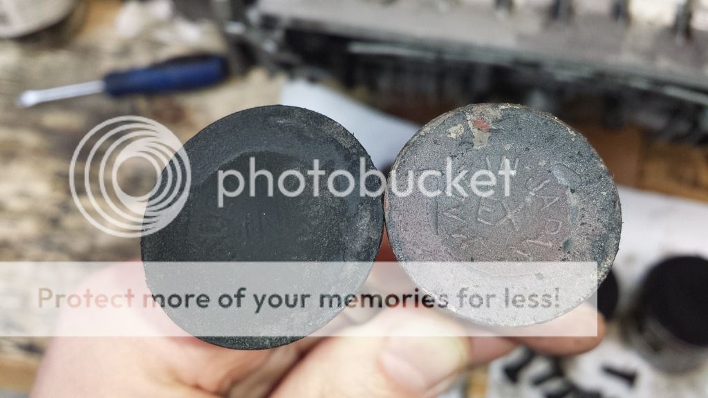

Here's a shot of the worst valves, all exhaust.  Probably not worth reusing?
The valves have "CR" on the stems and say "Made in Japan" and IN or EX in raised letters on top.  Are these just stock valves?

I know it's not that exciting.  Certainly not as much as Bill's recent engine trouble.
I have never seen that type of valve,with markings on them,kinda cool.bill

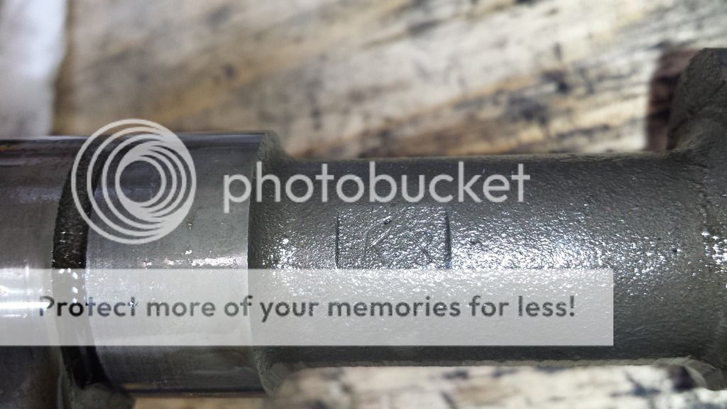

Norris used to mark their cams on a flat spot..got a cam pic... Plus they were a grey color.
The big valve clearance sure hints at a cam..Did it have decent power ?

Stikman What do the heads of the valves look like?
Interesting.  I expect the excessive valve lash is more due to lack of maintenance.  The PO was that type to an extreme.  But now you've got me thinking and I'll have to do some measurements on the cam lobes.  The lobes are pretty worn, and the hardened surface of the rockers equally so.  I only ever started this motor once and it smoked like a pig.  Can't speak to how it felt.  But given the ring gap placements I can't imagine the compression was very good.  Ports haven't been touched before.
Valves look straight to me.  Anything specific to look for on the heads?  Nobody seen those CR valve markings before?

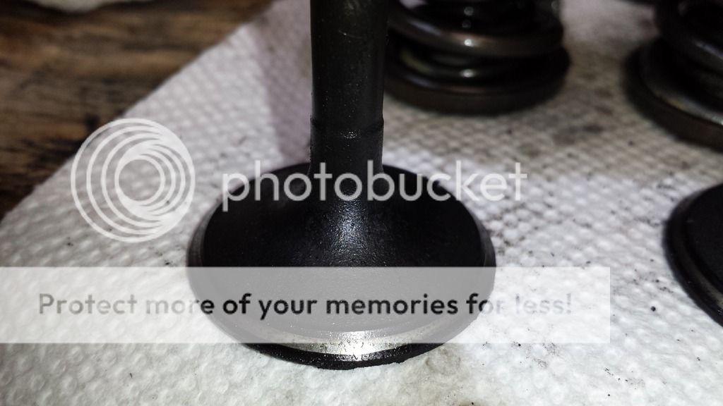

I was curious as to the shape of the valve head.
Valve heads look fine, albeit coated in carbon.  But they don't look to have been hitting the pistons.  The pistons measure about 2.4", so 61mm stock size.  Intake valve head measures 32mm, and exhaust 28mm.

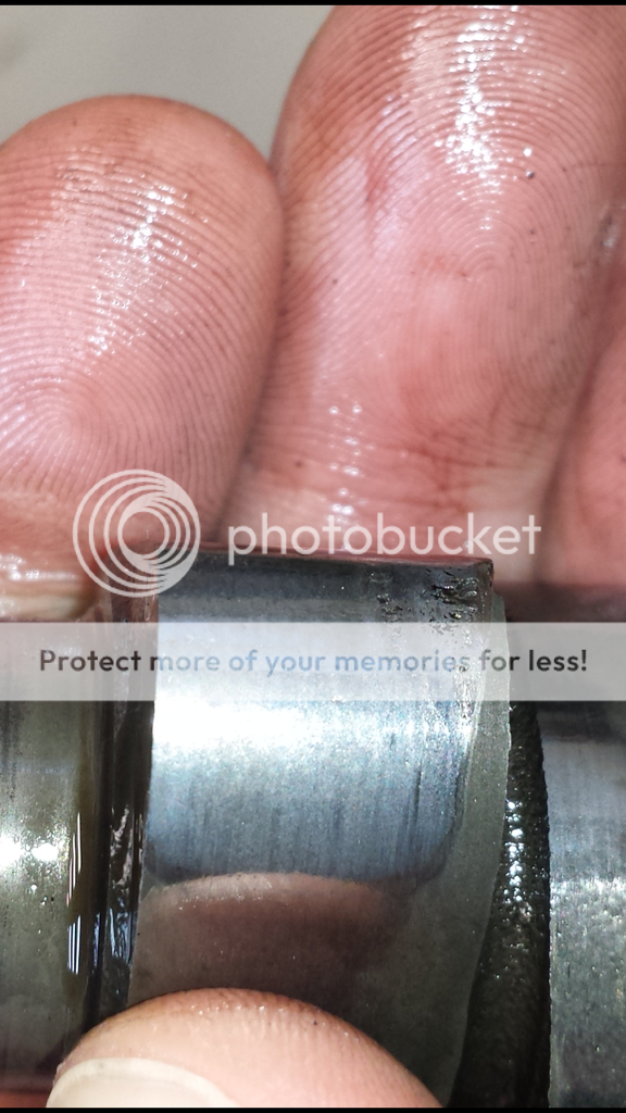

Here's a shot of the cam marking, "K8".
Lobes are pretty worn with some pitting.  I'll get some lobe measurements shortly.

Do the valves have the stock shape or flat like aftermarket?
They are dished in the center like stock valves.  Just the raised lettering in that dish that I've not seen before.  You can see that in the pic I posted earlier.

The head side, where the shape is. I can see the flats. Lol
Got it  :P.  They have the same ski slope lip around the edge as stock valves.

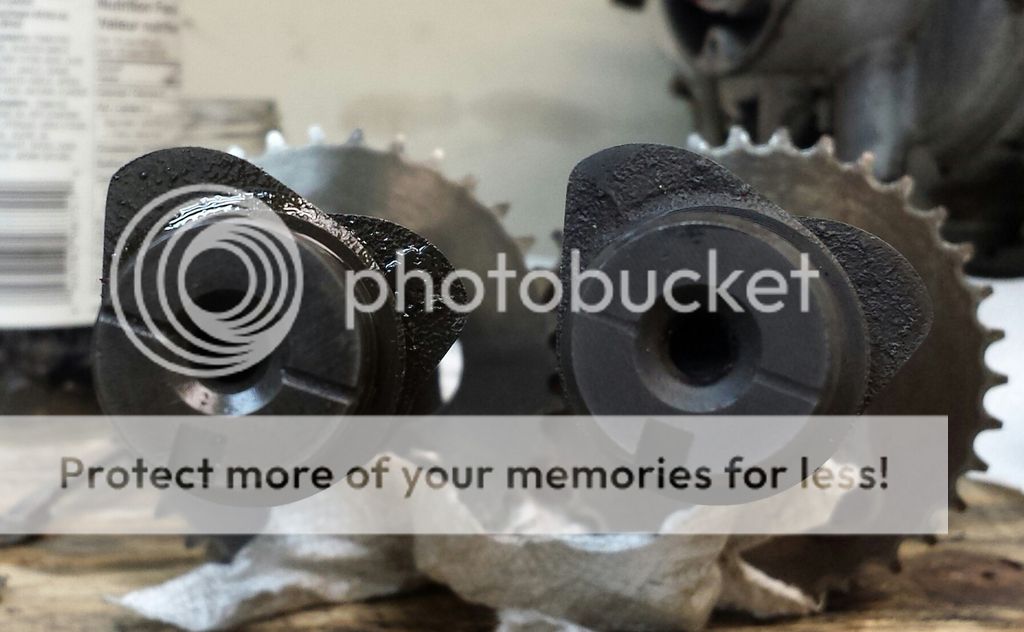

From what I can tell, the cam lobes measure similar lift to a stock cam, if not a hair shorter from wear.  I compared with a good K1 cam I have.
Base lobe:  1.110"
Intake lobe:  1.396"  (1.405" at the less worn outer edge)
Exhaust lobe: 1.386"
This cam left, K1 cam right

Sound like around  .375 lift..more than stock. To my eye it looks like a bit more duration.
The cam looks sorta grey in the R8 pic....does it look different in color than the K1 cam ?

1.396 - 1.110 = .286

IN 1.396 - 1.110 = 0.286
0.286 x 1.1 rocker ratio = .315 valve lift
EX 1.386 - 1.110 = 0.276
0.276 x 1.1 rocker ratio = .304 valve lift
And color looks the same to me.  The cam has the normal R#, on this one it's R13, but the K8 stamping on the flat spot is extra.  It's weird and all, but the cam still looks to be stock to me.

I have a set of CR rods here....they are POS parts.
Hmm okay, good to know.  Probably just cheap stock-type replacement parts eh.  Well I'm planning to replace the valves anyway, seeing as the rockers hammered a few of them and the raised letters can't be good for flow.  Do you think oversize intakes would be overkill with a wiseco 836 and webcam 41?  (I'll be deshrouding them anyway)

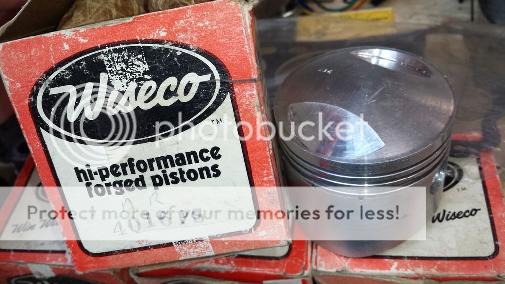

Final question for the day, what would be the recommended piston to wall clearance for NOS forged Wiseco 836cc pistons (4016PS - no micro grooves) in stock sleeves for my application?  Is less than .0020 getting too tight or is it reasonable as long as you take your time breaking it in?

 I'd run those old Wiseco's at .002
