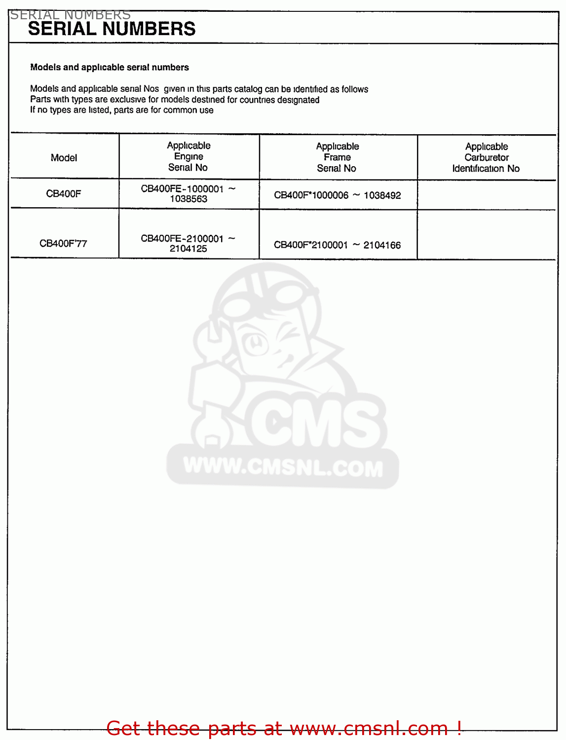

Additional question: None of the engine number charts I've seen include engine numbers with the "F" that mine has. They all say  "Engine#: CB400E-1000001." Is it normal to have the "F" in the stamping as well?
