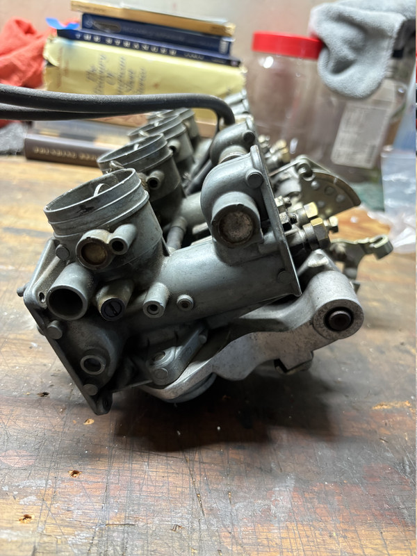

So the other thing I have to do to get this bike started is to rebuild the carbs. When I got the bike I received an assembled carb bank, and a bag of removed parts. The bag of parts looks complete, but I've ordered a carb kit because I have no idea the condition of the brass and all of the rubber is dry (o-rings and boots/isolators). I now have the carbs completely disassembled and ready to go through my Vapor Blaster and Ultrasonic cleaner.

   Before going any further, lets identify what kinda of brass you currently have in your carburetors, and then identify what type/brand of carb kits you've purchased. If you don't have the original kehin brass and needles you're going to struggle getting the carburetors to perform as they should with aftermarket brass, needles and o-rings.

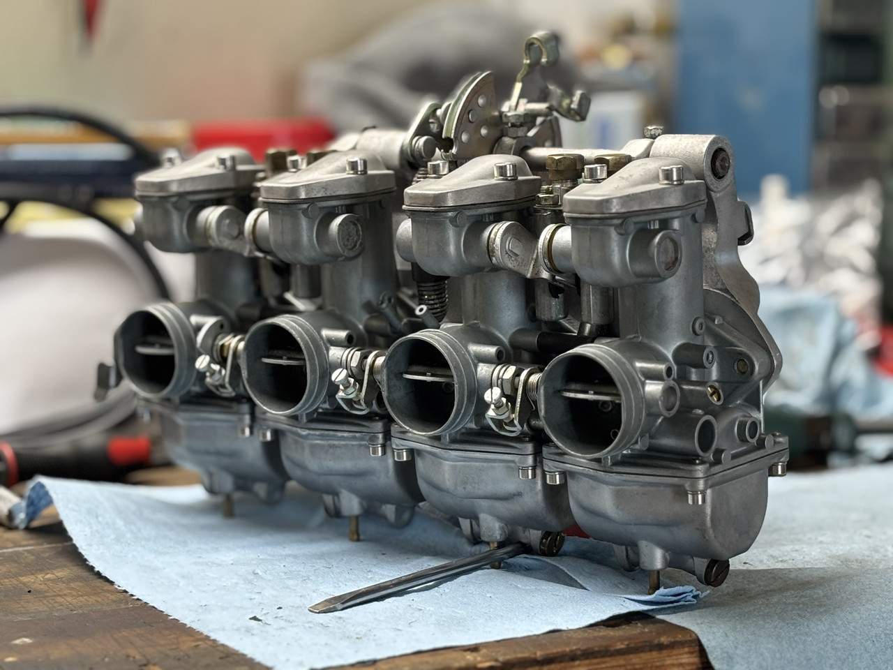

I wouldn't use the Vapor Blaster on the inside of the carb throats or the slides.

Looks like you've got a good solid base to work with. Always curious to me when someone would pair a cafe racer seat and chopped rear fender with the stock (huge) turn signals -- maybe they didn't get far enough along to replace them. I just put a '76 550F1 back into original shape -- I guess I technically could say "nut and bolt restoration" because I replaced a lot of janky hardware and allen head bolts, but it's also just a very clean rider.
Bummer about the exhaust, but good to know you've found a header at least. Not sure where to find a muffler. Mine's stock but it came with the bike, and I've poked around a little looking for another but come up blank.
For the carbs, this is certainly true:
   And pulling a rack of carbs on a stock 550f is a immeasurable PIA. Right about the third time I'd done it my first thought was, "I'm not doing this again if I don't have to."
But it is also possible to (very carefully) switch out internals like jets and float valve with the carbs on (although I broke a float tower doing it months ago...). I switched out allen bolts for the stock JIS for the float bowl screws, only thing I kept allen bolts on. I had taken the carbs off and on a few times after replacing the pods with the stock airbox and while tinkering to get it running right at altitude -- I'm at about 7500 feet elevation.
The stator cover plate is still available -- I think I got mine from CMSNL.
I've got a spare set of 069A carbs for the 550F with original brass. I bought a spare set, and an extra carb, and then found another super clean set at Bob's Salvage in PHX. I'm selling the rack for what I paid for it: $125 + shipping, and it's all there, just needs to be cleaned. HMU if you're interested, and best of luck.

Scottly - I have a lot of experience with Vapor Blasting. I use a 170-325 grit on carbs. I hold the nozzle (@55psi) about 1/2-inch to 3/4-inch for polishing, and 1 to 2 inches for cleaning. The interior of carbs get cleaned only. After they go through the VB, they get rinsed and then go into the ultrasonic for 20 minutes at 122F. Here is #1 done:

Before and after of the carb bank:
Hopefully I'll have it running tomorrow. I'll get a quick ride to see what works and what doesn't...and then into pieces.

Offline denward17
  • Posts: 1,878
Re: 1976 CB550F Super Sport
« Reply #12 on: November 18, 2025, 11:49:10 AM »
Looking good!
Did you do a bench test with fuel before installing?
Might help if the floats are stuck.
Clear tube test?
