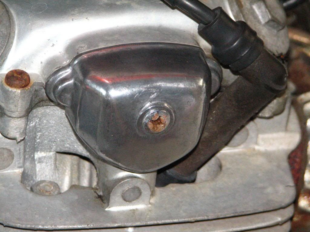

I went riding today, even though upon my initial inspection of Cassandra, I saw this:
hmmm....  what is that stuff near my spark plug?  I've never notice oil or gas around my spark plug before.

Give the engine a good cleaning and ride as usual.  This will help you to see exactly where it's coming from.  From that picture, though, my first choice would be the rocker shaft seals.  If you pull the rocker shaft end covers (the part in the picture with the large phillips screw) you'll see what I'm talking about.  Each cover has two metal plugs with o-rings on them that seal the holes at the ends of the rocker shafts, and if the o-rings aren't doing their jobs properly, oil can leak past them and out through the bottom of the cover.

Has it been apart recently? If so the soft washer under the bracket that holds the end cap may not be there, or damaged

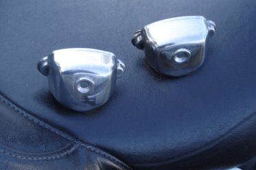

Once again, thanks to all the folks who helped.  Honda had 2 of the O-rings I needed.  I ordered the other 2.  (I plan to do both sides.)  I put the screws in wood bleach because they didn't have the screws either.  Those are on order to.  Polished both of the covers up.  They now match all my other polished aluminum.  Gotta love a happy ending:
