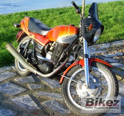

« Reply #5 on: October 25, 2007, 06:48:37 AM »
Or a bit closer to home:
CBX550
SOHC4 Member #2393
2015 Tiger 800 XRT
1971 CB500K0 (US Model)
Offline Raul CB750K1
  • Posts: 3,881
Re: The latest in Cafe Racer wheels!!
« Reply #6 on: October 25, 2007, 07:16:09 AM »
CBX550
Legend says that Honda copied the idea to Sanglas. As Alejandro de Tomaso said when he was accused of copying Honda in his Benellis, "There is no crime in stealing from a burglar". After all, Sanglas copied DKW and other british designs in their first bikes.....

Raul..was this a single side disc, sort of like a trailer brake??
and what does the CBX 500 use.
  • Posts: 3,881
« Reply #8 on: October 25, 2007, 11:06:13 AM »
It was a single disc. Two pistons at each side of the hub would press the pad against the inner disc.
CBX550
MVX250F
Sam. ;)
