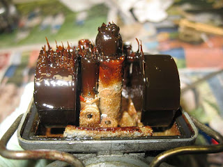

what if your carb looks like this....
and this happens when you go to remove the float....
Think it's savable?

All Hail Kroil. Use a small drill bit as a punch, if nothing else is handy.

jesus i thought my carbs were bad. those are probably the worse i have seen :o

Holy crap! That look like a hot fudge carb sundae...mmmm... sundae.
