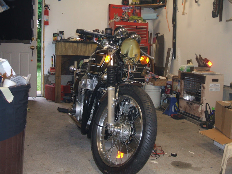

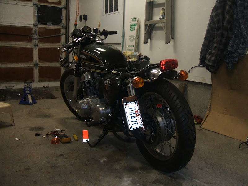

I happen to be doing the exact same thing to my K3. I took the rear shocks apart and cut&re-threaded the shock shaft and then took 1 1/2 coils off of the springs. The final shock length comes in at a tick over 11 inches. For the front I had originally slid the tubes up into the trees but then I had issues fitting the drag bars & master cylinder. So I popped the springs out of the legs and whacked 1.5 inches off and re-assembled. How does it ride? can`t tell ya just yet as I`m still sorting thru the small stuff (wiring/seat/gotta make plug wires up, etc.). I`m not too terribly concerned about any negative handling as I`m not into hammering on it and I got it lowered pretty evenly front to rear so the geometry should be very close to stock (I think  :D). I`ll post up more when it`s finished (soon I hope).

The main issue with cutting springs, whether front or rear, is that by taking coils off the springs you're making them stiffer.  Probably not quite as noticeable on the front because there are so many coils, but there aren't that many coils to begin with on the rear shocks.

Good point, when I took the rears apart I was able to compress them by hand (ok...body weight) to get the split collars off. When putting it back...NO way. I wound up using the press at work to get the whole shebang back together. I guess that would be a pretty IMPORTANT part of my previous post that I left out huh?lol.
