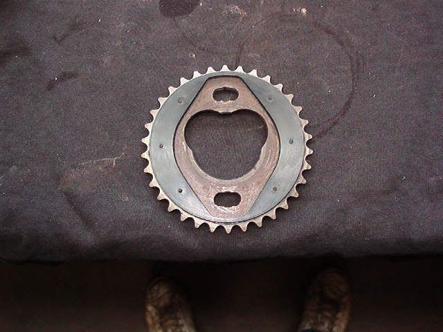

Could someone show me a slotted cam gear? And how did you slot it?

what it is is, the sproket mount holes are elongated , so that you can turn the cam while the sproket stays put , dynoman sells them for the 750,   i made mine with a dremel, and wouldn't do it again (it was a real #$%*, and took forever)
i used a burr bit in my drill press. it really took so little material removed to gain the 5 degrees movement i needed.

Rotary table on a mill. It doesn't need to be elongated this much but while it was set up...
