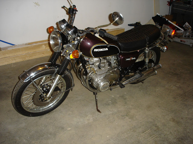

Just wanted to introduce myself. Looong time lurker, recently joined as a member and just picked up my first CB550, a 1974. Motorcycle has been stored in a garage for almost 30 years and still has what I believe to be the original Bridgestone tires and just under 3900 miles on the odometer. Looking forward to the reconditioning process and spending more time here not only acquiring info but maybe helping out when I can.
It's pretty dirty right now, everything needs to be cleaned well and the chrome could use a good polishing. Looking forward to this project!

Thanks for all the welcomes! Unfortunately the 550 takes a back seat to some work I'm doing in the house right now but I did have a chance to get in the garage for a few hours tonight and really assess the bike's condition. Found all of the previous owners registration paperwork in the owner's manual compartment under the seat. He had written all of the mileage and maintenance data in the last page of the book and it looks like he put on a couple of hundred miles every year he rode it until it was put in storage after 1982. It also looks like at some point the bike was given a generous coating of wax without it being properly rubbed off. I took my thumb and really rubbed into the chrome with it and this coating of wax started to rub off revealing some nice shiny chrome underneath.
I suppose I'll start a thread in the projects section when I eventually get around to tearing this apart to have items refinished, etc. I think I'm going to get it roadworthy for the summer and just spend a summer enjoying it the way it is.

Just wanted to give an update on the work I've done so far. Sorry for not having in between photos, I'm really quite bad at documenting things. I'm sure in 30 years when my memory isn't nearly as good I'll have to start taking photos so I can remember basic things, like where I live, what kind of car I drive......
Anyway, I've been working pretty hard for the last 4 weeks or so when time permits. I've basically gone through every component of the bike at this point and she started and ran today for the first time.

Anyway, sorry for the rambling, here's a picture of where I started and where the bike is now:
Then:
Now:
