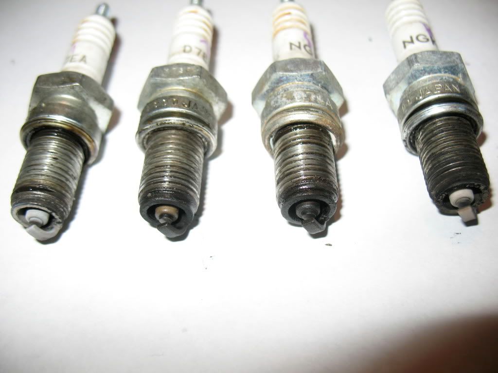

Pulled the plugs today, looks like I've got a range from too lean to too rich. That should make it fun to balance them out. Picture attached.

couple of those look oil fouled.  Valve stems seals maybe?

fmctm1sw: Yeah, one plug definitely is oil fouled. No bueno.

You need to figure out why all the plugs don't show the same style deposits.
