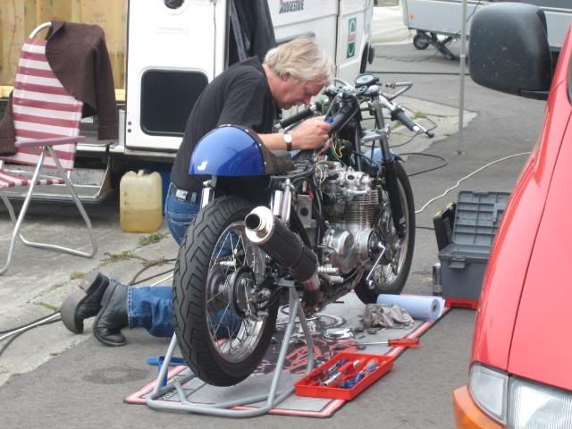

Agree with TG about the rules, it's like that in Holland too. This is one of my favorit, a really fast 500 with builder/rider Frank Lemstra.
Rob

nice bike indeedy! more shots?
well, rob, at least they let you run with a 4-1 in NL.
peter told me he MUST run a 4-4 exhaust in CRMC, "honda 1967 GP style"...

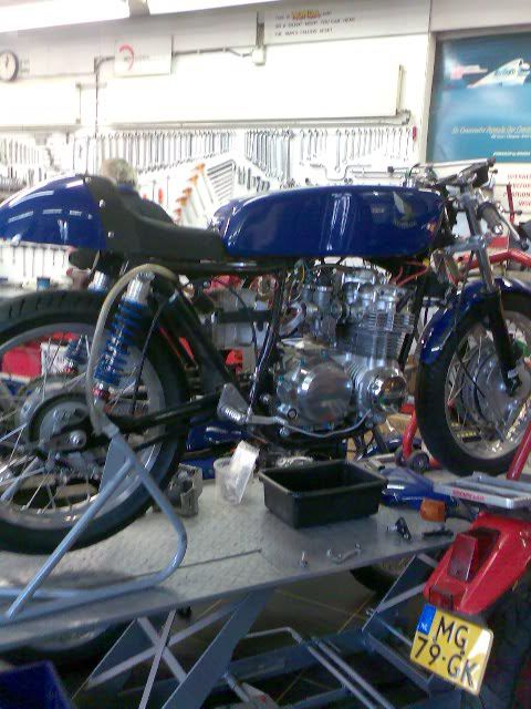

It is one of the nicest I know and Frank is a well known SOHC guru in Holland, and a wonderful guy, used to race a CR750 in the 70's too. He races a lot in Britain too.
Got pic, not sharp, taken by phone:
And fiddling with her:
4 into 1 allowed but look at that size muffler! Need to be so big due to regulations. Really hate them for that!
Cheers, Rob

Real nice,whats that front brake off of ? Bill

Hey Bill,
That 's a RC181 replica front.
