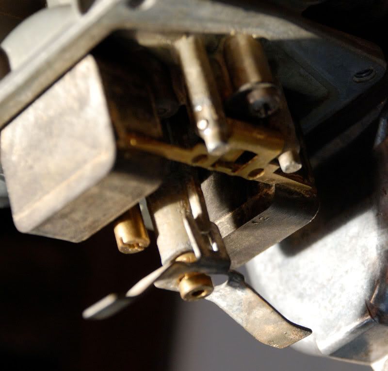

second question is about the carb float stoppers?  the part isnt labeled in my book, so i dont know what to call it specifically. sorry for my vague-ness.  first thought is, maybe i have the wrong part, but... the semi "u" or "Y" shaped part that comes off of the tube where the cylinder that houses the needle is, makes it so the float bowl needs to be pressed on in order to start threading the screws... does this sound right?   when i put the carb parts all back together and the bowl on, before i start screwing the bowl on, its resting on those wing looking things and thers about an 1/8 inch gap between the bowl and carb body...

Second part....your putting your floats in upside-down and pressin against the tab that normally limits the amount the float can 'drop' when you drain the bowl/ remove the bowl.

That "thingy" you are describing is what hold the main jet in place.
yes, you'll need to press the bowl down onto it before you start tightening the bowl screws.  dont overtighten these as the bowls are soft metal and will strip easily.

alright, im more of a visual learner, so heres what ive got...cause it looks like, according to the manual, nothing is upside down... or am i completely over looking something more than obvious... thanks again,

Everything looks good in the carb. You do have to apply a little presure to get the float bowl screws started. Exercise caution because the threads in the carb body can strip easily.

Duuh, I should have looked at a pic. of your carbs first.....!!!    I can see how that tab sits against the bottom of the bowl now...............
