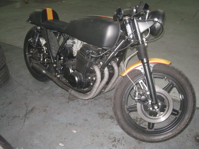

i have a mini supertrapp welded onto my oem headers. I really like the sound of it, kind of grunty and frees up the back to expose the whole back wheel. I run full disks.
