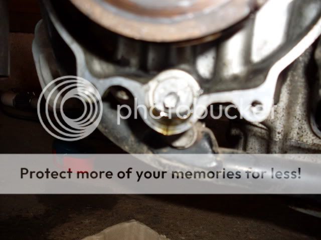

Victory is mine!.... well sort of. I bought the battery, but it didn't come with the acid, so I ran to the local auto parts store to pick some up. While I was there I picked up some new thicker battery cables and starter cable(not factory ones, I just made them work), because I decided that although mine were passing current it only cost me $12 to get all new cables.
I charged the battery all last night, woke up at 7am and started to put all the new wires in. After I was done doing that I hooked the battery up and hit the start button.... VROOOOOM. It fired right up... it revved really high, so I shut it down. Fired it up again and it idled for about 15 seconds or so before dying. Victory!
Now when I hit the start button, nothing happens. I have it narrowed down to the start button or the relay, because now if you jump across the relay terminals it will fire up. So the electrical demons are still possessing the bike, they just moved around a little bit :-\
Thank you all for all of the information ;D, I am still not 100% sure what the problem was, it was probably a combination of things, but between the battery, starter brushes(which I did sand and clean), and the new wiring... but it at least starts now.
I do have another question which is unrelated to the starter, so maybe I should start a new thread if so, let me know and I will, but now that the bike is turning over and running, it leaks oil pretty badly from the left side of the engine. It is a constant drip. Here is a picture:

Looks to be your alternator in the pic? Not familiar with the 650, but on the 750, there is some oil back there. If things are the same between the two, once you have a new gasket and cinch down the alt. cover, there will be no leak.
Offline Hush
  • Posts: 6,761
Re: Starter problems - 79 cb650
« Reply #15 on: September 19, 2009, 09:58:40 AM »
I'd try the new gasket as suggested but mine is fairly dry in there, might be a  wee leak coming from somewhere, may not be worth worrying about unless you are losing bucketloads.
If you now suspect the starter button, try not to dissasemble the handlebar switches too much unless you have very tiny fingers.
They are a pure #$%* to get back the way they should be.
You should be able to clean the contacts up without too much taking apart.

Ding Ding Ding! we have a winner, the problem lies in the starter relay, I tested the start button and it is transfering current as it should be. Why the starter relay decided to die the day I actually get the bike up and running I don't know, but I ordered a new one and hopefully that is the end of that problem.
The leak is coming from that little dowel type piece (I don't know what it is). I can wiggle it and there is a very very slight movement which is why it leaks. I don't know if it is suppose to do that or if I can grab it with some pliers and pull it out and re-seal it, or of I can do as some of you say and just get a new gasket and call it a day. I just don't want it to fill up with oil if it's not suppose to.

I've searched my manuals for information on that "dowel" thing but it doesn't get a mention, I'm guessing it is just a blank.
In that case I'd clean the area and then stick some form of sealer compound in there, loctite maybe?
You may need to lower the oil level in the sump temporarily just so it stops weeping while you fix it.

Just so everyone knows the severity of the oil leak. I put a spray paint can lid upside down to catch all of the oil and when I checked it first thing this morning, it was almost 2/3rds full. So I am afraid that even if I did get it on the road I would have to stop every 50 miles and add some oil.

I got the leak fixed. I just pulled on that little dowel with some pliers and it popped right out. Oil does come gushing out of there so be sure to put something under it to catch it. There is a little O-ring on the dowel, so I went to the local auto parts store and picked up a box of various size O-rings for $3 and found the one that fit... NO more leak!
Also... be sure not to push the dowel to far back into the hole because there is nothing that stops it so you can push it too far in and it can be a real pain to get back out.
