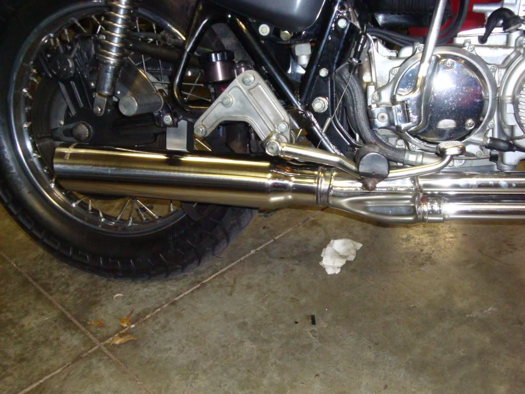

A member here DonR had made a stainless steel muffler for his F and was talking about making more if there was a demand.  Maybe check with him.

I made one and never followed up with more, but it is a 2 1/2" inlet 3 1/2" outlet the only hard part is welding the stainless bracket to the pipe. The baffle is from patriot. the one in the picture has a pint glue can for a baffle it looks gold because it is stainless. not as noticeable normally. One could also be made in chrome for a better match.
