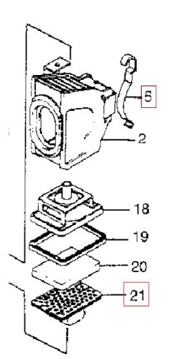

I'm trying to go back to the stock airbox on my 550. I've gotten most of the parts together, but I'm missing a couple and I need a bit of help with those and assembly.
Here's what I'm missing as far as "major" parts go:
I've found that the plate is still available from Honda (#21) but the spring is not (#5). Does anybody have an extra kicking around?
I'm also missing the various spacers (listed as collars on parts fiche) from the airbox and was wondering what material they were so I could spin up some replacements. As far as assembly, I need some help with routing the hoses as I have never seen how the stock box is setup.
