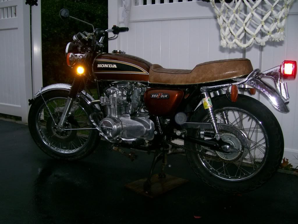

Alright, hope this works
*1976 Honda 550 Four
*2003 Kawasaki Vulcan 1600
*2000 Ford SVT-Lightning 426 RWHP 546 RWTQ
Offline Scott S
  • Posts: 8,252
Re: New Guy here !!! w a CB550 Four
« Reply #9 on: October 14, 2010, 07:37:21 PM »
 Not a bad looking bike. I personally think the seat would look better in black. That, and you need to sell me that exhaust.
 Are those highway pegs?
 Don't be too afraid of the carbs. They can be VERY frustrating, but the worst part is taking them on and off over and over again to work on them. The actual work is tedious and time consuming, but not hard.

Offline jimkalfakis
  • Posts: 57
« Reply #10 on: October 14, 2010, 07:51:49 PM »
No Scott, I`m not scared to do them. Let`s face it, who the hell has the time. The seat is ultra-gay. What you haven`t seen was the massive sissy-bar (with lights on it) that I removed before taking the pic. There`s no highway pegs but what you see are custom twisted square bar engine guards. I think the guy before me was going for the chopper look. The exhaust looks aftermarket with the baffle gutted out. I`ll need a new exhaust, it`s way too loud.

  • Posts: 35,342
« Reply #11 on: October 14, 2010, 07:54:06 PM »
Agreed, nice looking bike. But, the seat, let's just say looks a little odd.
And you don't need highway crash bars...just sayin'.
Just remember, it's your bike and do with it what you please.

  • Posts: 17,312
« Reply #12 on: October 14, 2010, 10:04:15 PM »
its an ex "pimp my cb"bike,looks bloody good,ill have ten at that price,have a gander though the faq section and download the workshop manual,the 500 one is the same more or less,you can ,or should drop the bowls off the carbs to get the final finest crud out that will block the tiny jets in the idle circuit,you can replace the needle and seats without dropping the carbs if your not ham fisted and check the float heights as well,ill guess a little crap has gotten stuck and just needs that final clean out,good luck and welcome.

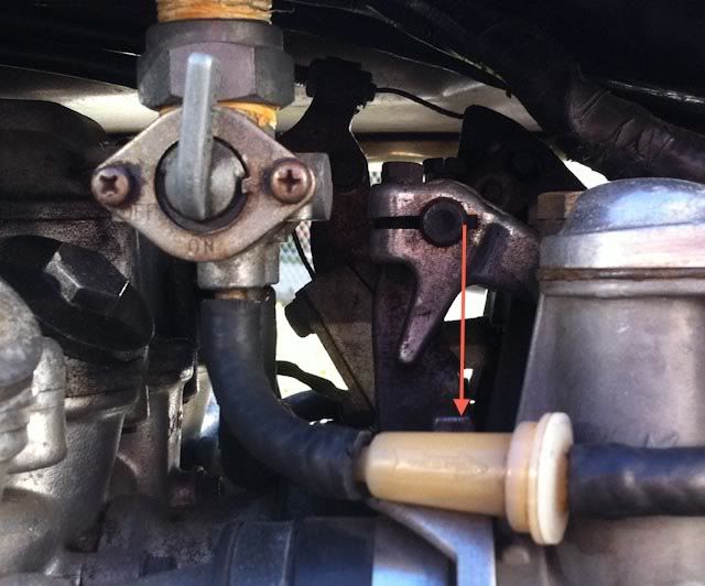

Congratulations on the new bike.  I am VERY close to getting one very similar - but in much worse shape :)
Guys, can you tell me if this picture shows the in-line filter you are speaking about.  The seller pointed it out shortly after I looked inside the tank (which didn't seem that bad to me), which struck me as a potentially shady, easy fix to a bigger issue.  Just a gut feeling.
Can you explain why you prefer to avoid these?
Yes, that's the inline filter and the petcock is set to reserve. If tank and fuel is clean and stock filter is good and in place, there is no need for an additional inline filter.
« Reply #22 on: October 15, 2010, 08:01:45 AM »
In this setup, has the hose/line been cut?  I would need to get a stock line if I were to remove them? Sorry, very, VERY newbie here!

« Reply #23 on: October 15, 2010, 08:38:37 AM »
Appreciate your time folks.
yes you can get stock line that will go from your carb to the petcock.  Then you cut the hose and insert the filter with the arrow pointing toward the carb.

Offline Deltarider
  • Posts: 8,613
« Reply #24 on: October 15, 2010, 08:52:06 AM »
... and you'll have a good chance the line will kink and block fuel flow. That has happened with mine. With stock tank- or petcockfilter in place, there's no need for extra filters.
