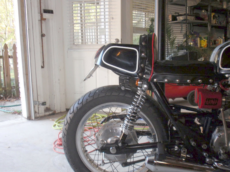

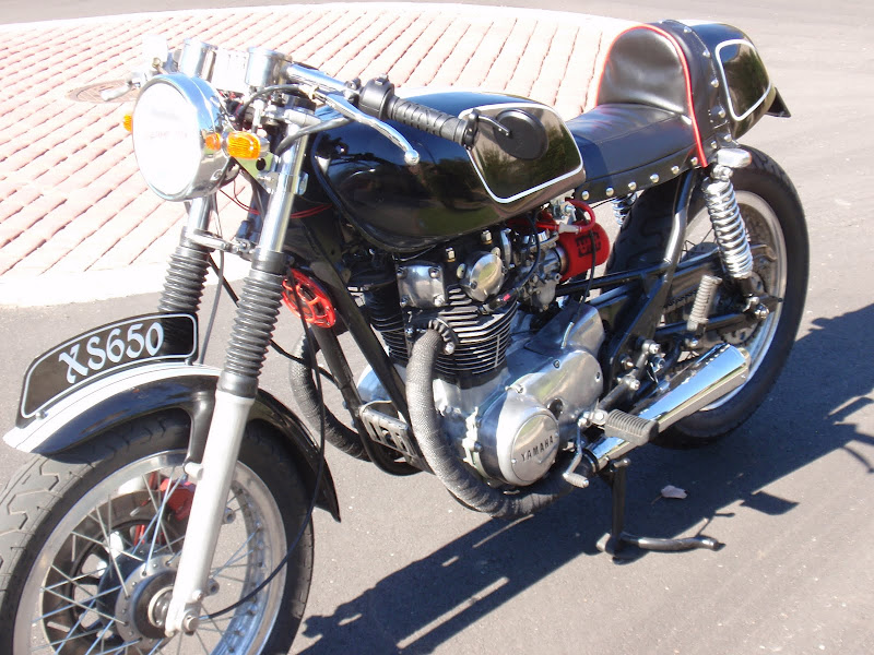

I just ordered a custom cafe seat from Eric Tran @ HondaClassic31.  He makes seats that have original seat mounting points. I haven't received the item yet but it will look like this one with addition of pleats.   I wanted original mounting points and a small storage space under the seat.
