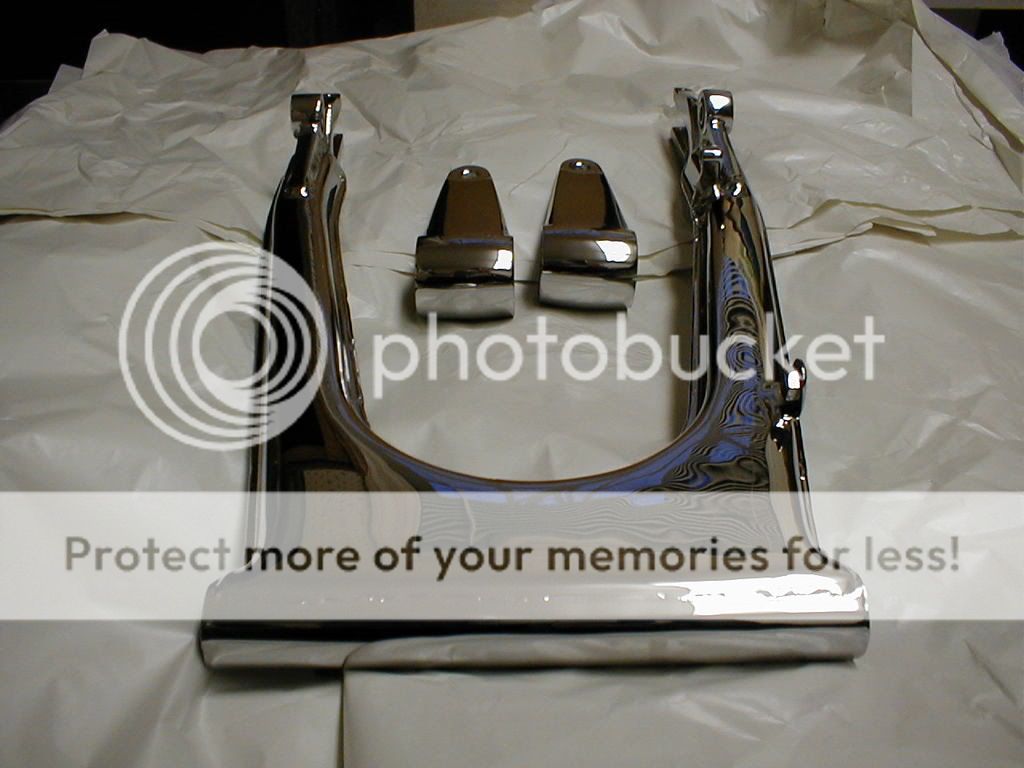

Brownsplating,com in kentucky is the go to place for highest quality. Yes they do bolts individually. I had several tips of bolts and like the tip of the brake pedal spindle plated. They do everything in reconditioning the part, buff out scratches, casting marks, etc. Have to talk with Ron Brown. But check out the website, there is a price list online, but hold on to your ... whatever.
They like to make things shiny show quality, but if you want to dumb it down to production quality which many restorers do, they can do that too. They advertise in the Vintage Japanese Motorcycle Club magazine.

Holy balls MC, those pieces look awesome! I don't think I even want to ask what that all cost...

I about crapped my pants when I saw that swingarm.....talk about bike porn -
OK,i'll ask.what did cost?
I've been away for a while.
Here's the retail catalog. CB750 has its own page. Download and scroll down. They were never higher and often lower than the price in the catalog, and you get 10% off for mentioning their website. Still pricey.  They also did a lot of polishing to remove casting marks and warts that others would simply chrome over.  The swingarm was $215, Headlight ears $67.50 ea., etc.
