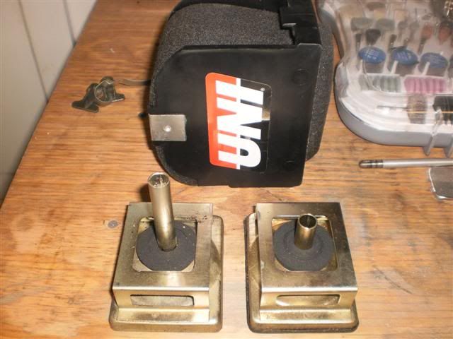

 I found a local fellow who is making some changes to his '75 CB550 and worked out a deal for his air box, boots and a Uni-filter (as well as a NICE seat to replace the Corbin Gentry on my '77, but that's for another thread).
 I wanted to replace the paper filter with the Uni and maybe swap out the busted #1 air box to carb boot, but when I got it all home I noticed that the boots are different. The boot on the '77 seems longer than the one from the '75, which appears to be the same as on my CB500.
 Are the '77-ish boots available?
Also, when swapping out the filter, I noticed that the "breather" or element that goes in the bottom of the airbox is different. The one in the '77 had a short pipe on it, the '75 a longer pipe. I just put the element with the longer pipe in the later air box so I coud run the Uni filter. The stock paper filter would not have worked with the longer pipe. I don't guess there's an issue with doing this, huh?

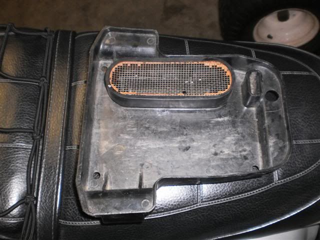

 Also, the '75 tool tray has a screen over the inlet. I'm running a tool tray on my '71 (which I don't think even came with a tray, originally), but was wondering if there's any benefit or hindrance to swapping it out to the screened tray?

 The tray wouldn't work in the '77 (without mods) because of the vent tube from the gas tank. It has the snorkel type top. Should I keep the snorkel in place as Honda intended, or is there anything to gain by removing it?

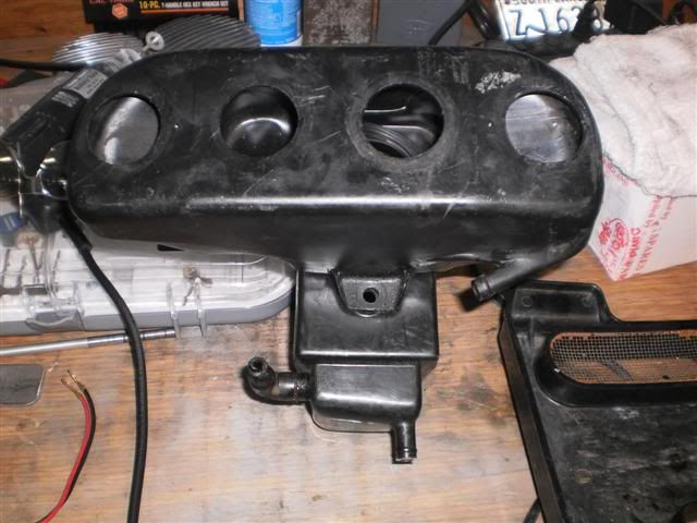

 One last pic of the '75 air box. The intake plenum appears to be the same as on my '71, but the air cleaner housing has a couple of vents/drain tubes that the '71 does not.

that airbox tube will still work you are right they are slightly different you may have to rotate it a bit to get the best fit and there is no benifit to using the tool tray other than a place to put your tools on some rigs it actually restricts the air flow a bit that type of filter element wil probably require you turning the air screws on each carb in clockwise a half turn

the two on the right and the bottom usually have caps over them the one on the left with the elbow usually goes to the vent pipe coming from the valve cover on the top of the motor

 I'll have to check the '77 and see how that's all routed.

The air horn and the inlet opening in the tool tray supply plenty of air for stock motors.  If anything, the air horn is a bit bigger.
My 72 Cb500 also has the tool tray,  I don't know about the 71.  But, I assumed it did.  I know of no other place for the tool kit on the CB500.
If the bike was originally supplied with an air horn over the air filter, (75-77 F models and 77-78 K models), then the tool kit fit at the rear of the seat, in the seat.
