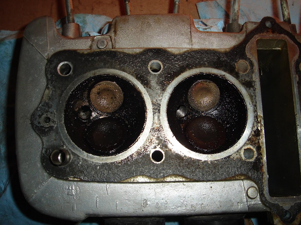

Pistons, eww...

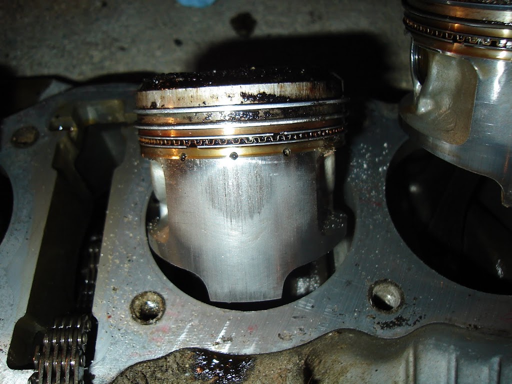

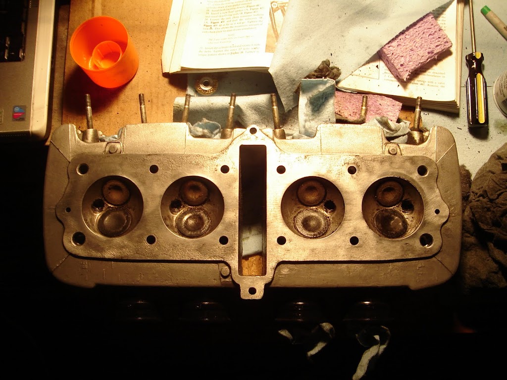

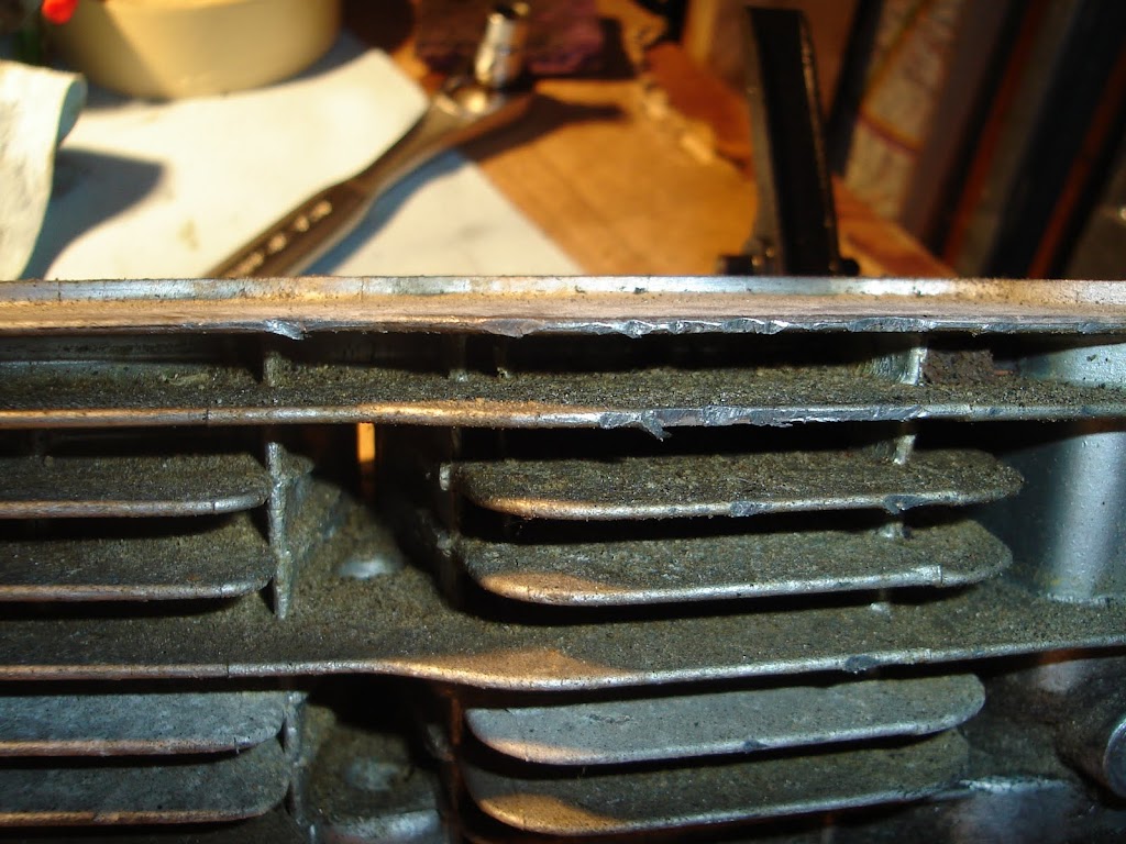

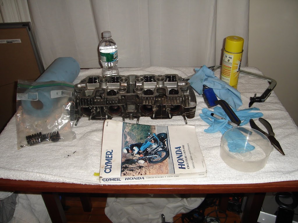

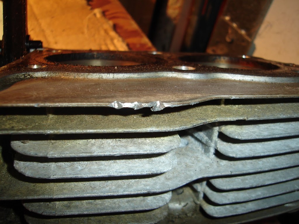

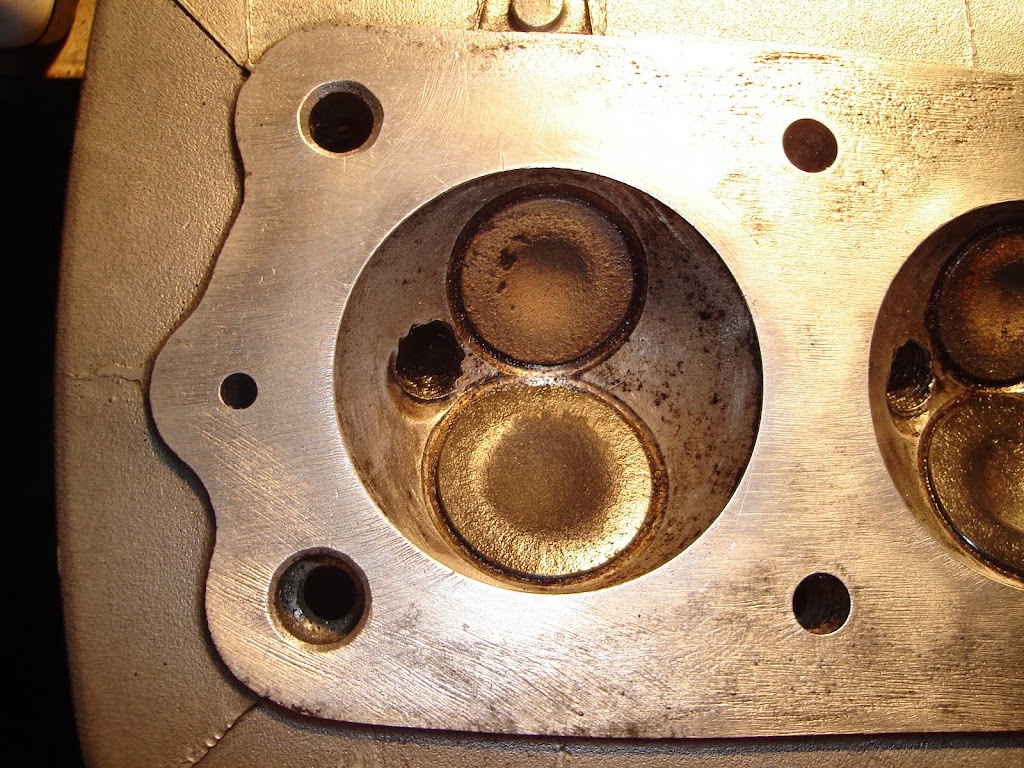

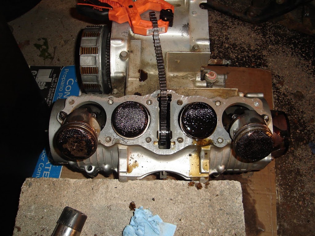

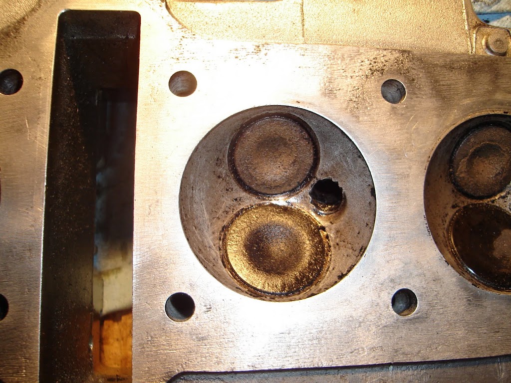

So, after taking a look at how my head and pistons look like, I decided that I would take charge and get that nasty carbon deposit off.  Clymer suggested using broad flathead screwdrivers and wire brushes to take the carbon deposit off.  I started with some bronze wire brush on my angle grinder.  What I didn't realize till after I was done was, maybe I shouldn't have done that.  I now have wire brush scraping where the head gasket sits between the valve assembly and the pistons.  Can anyone chime in on this?  Am I now locked into getting resurfacing done?  Are these scrapes ok and will sitting a gasket in between these two joints be enough to seal properly?
Also, I have a question about valve removal.  Is a valve compression tool absolutely required?  I could have swore that I read somewhere that someone used a socket and hammer to remove the pin from the valve spring?  I tried doing a search and couldn't find this.  Is this true or is the hammer and socket trick for something else?

Can anyone advise me on the surface pics?  My bronze wire wheel did some left some scrapes and marks on the aluminum head.  Will I need a resurface even if I find no warpage?

I think it would need to be taken down a bit. Some of those marks are could possibly cause a problem. There's no reason why you can't do it yourself though. A big piece of wet and dry paper glued to a flat surface (like an old kitchen top or piece of plate glass), place the 'head on it, rough side down, and move it in a big figure of eight pattern. It's not hard, just use light, even pressure and keep it moving.
Then again, a local engineering/motor shop might be able to polish it down for an affordable price.
 (no sound)
A valuable lesson learned. Mating surfaces should be considered sacred and only cleaned with tools less hard than the material (lead, brass, plastic etc.)
« Last Edit: November 08, 2009, 03:15:23 AM by Ogri »

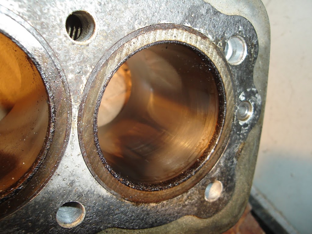

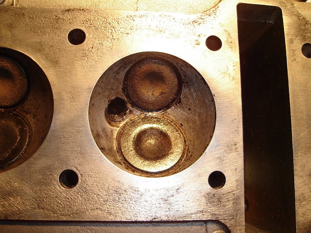

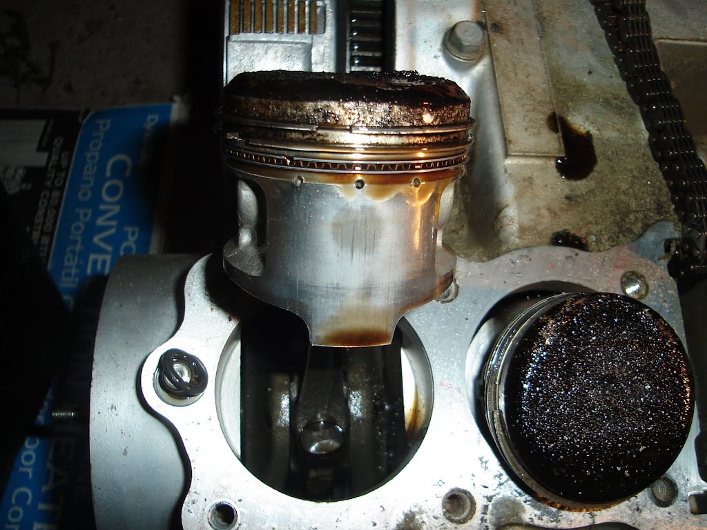

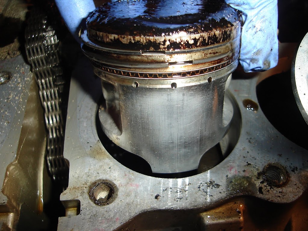

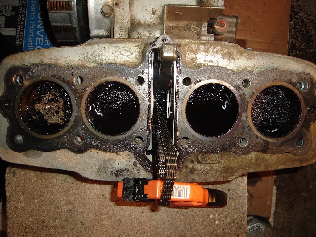

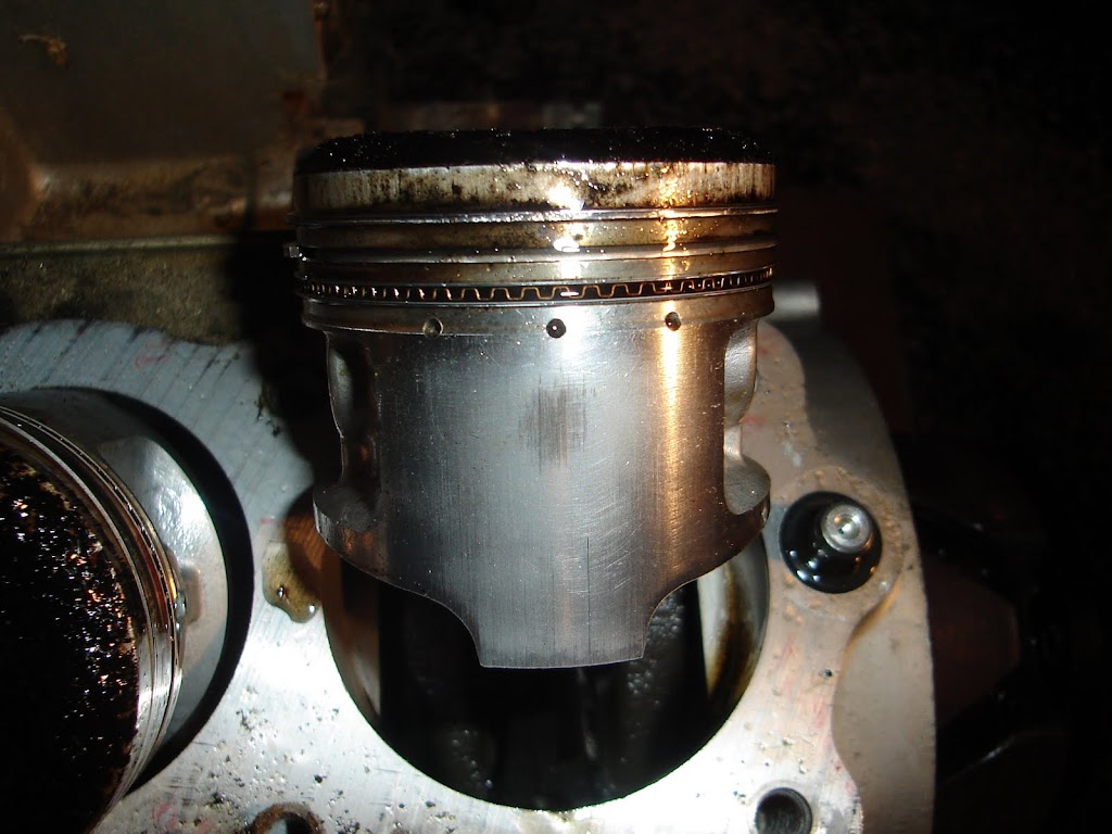

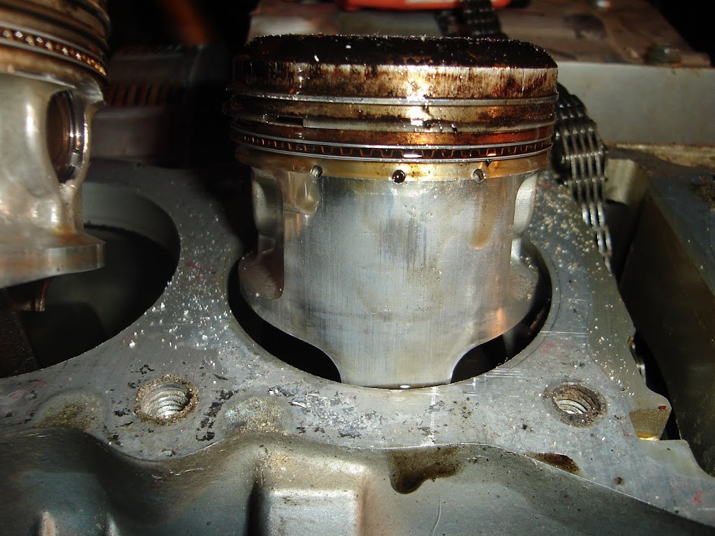

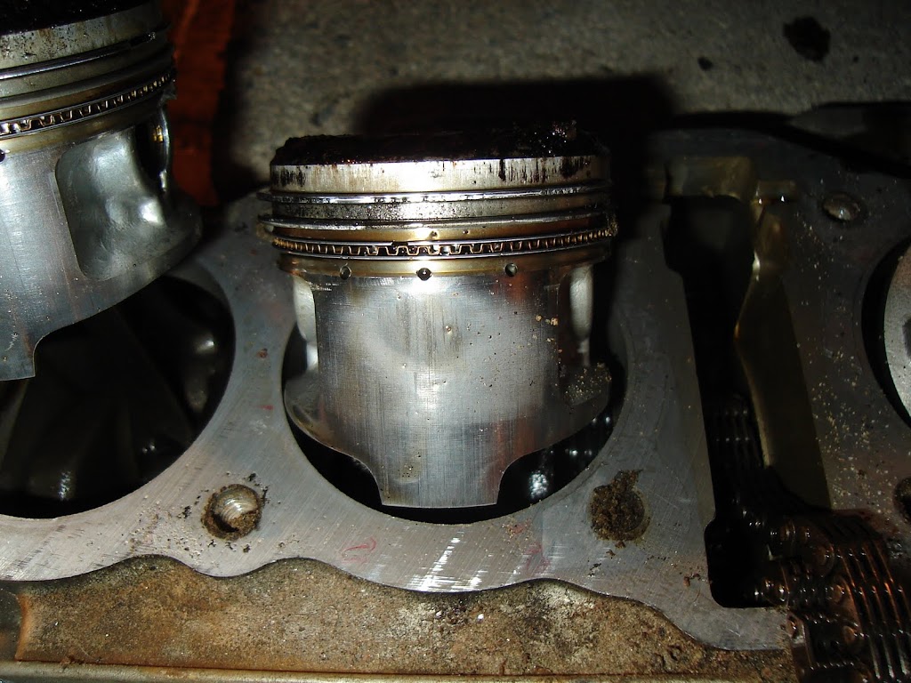

Ok, another update.  I got some time to go out to the garage to take the cylinder head off.  BTW, comments would be much appreciated.  I would like to know what everyone thinks about my pistons and cylinder walls.  The only things that I noticed were the piston walls had some wear on the sides.  I don't know if this is normal.  Also, I noticed that my first cylinder had some rusting at the top.
I attempted to measure the bore of the cylinders and diameter of the pistons, but I think my cheapo Harbor Freight micrometer isn't reading the measurements right.  All my measurements were not in spec.  When I say not in spec, it measured as if the cylinder wall bore shrunk, and the piston diameters grew.  I don't know.  I don't trust this micrometer.  I'll probably just get this professionally measured when I get the resurfacing done on the valve assembly.  Just need to find a machinist...

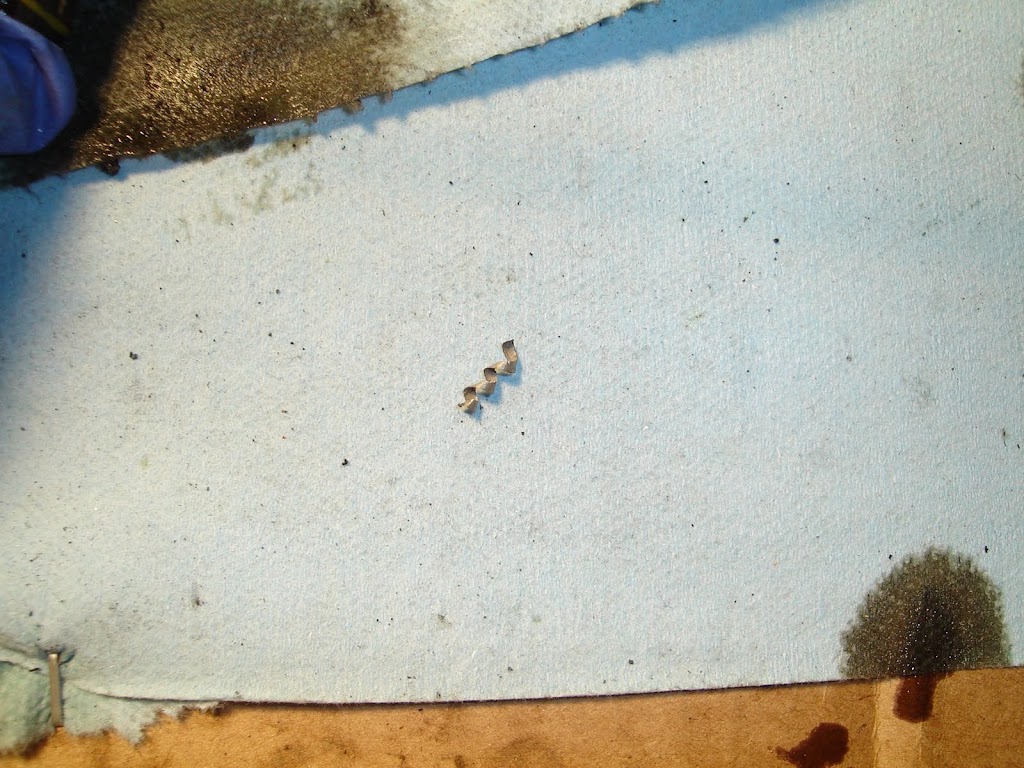

ALSO, PLEASE COMMENT ON THE FOLLOWING!  I found this metal shaving stuck between the cam chain tensioner and the wall of the cam chain opening.  WTF???  I couldn't find the culprit of where this came from.  Any ideas?
Pistons...  From left to right: piston 4, 3, 2, 1
Piston 4
Piston 3
Piston 2
Piston 1

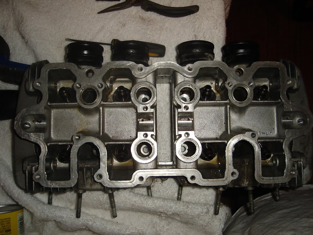

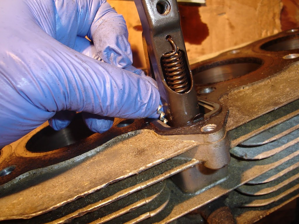

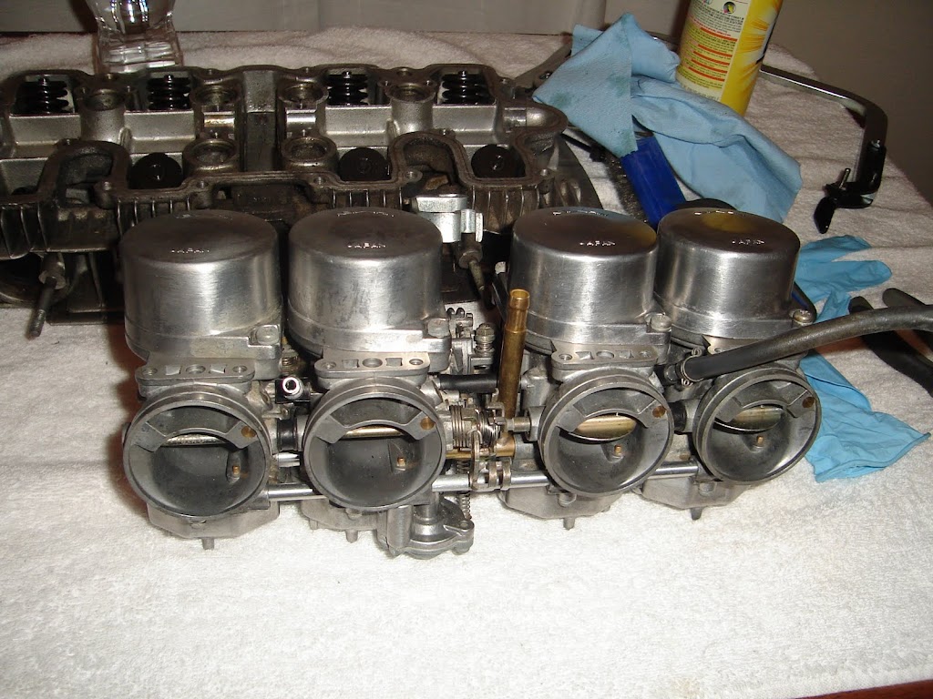

Just a short update.  Today I finally found some time to work on the bike.  Results are below
Carb is reassembled!
Valves removed
For the valves, I stopped by Sears the other day to pick up their valve spring compression tool.  It was only $19.99.  You can see it in the image below.  It's at the top right of the pic.  This tool work flawlessly to remove the valves.  Anyone needing to do this should definitely pick up this tool for their collection.
How bout for reassembly. It seems to me that I read a thread where the tool that was being used allowed the person to dissassemble the valves, but for some reason (I can't remember) they couldn't use it to get them back together. Sorry, not trying to be a downer just curious. If it works for both directions, I'll be buying one as well. I'm always happy to "need" another tool  ;D
