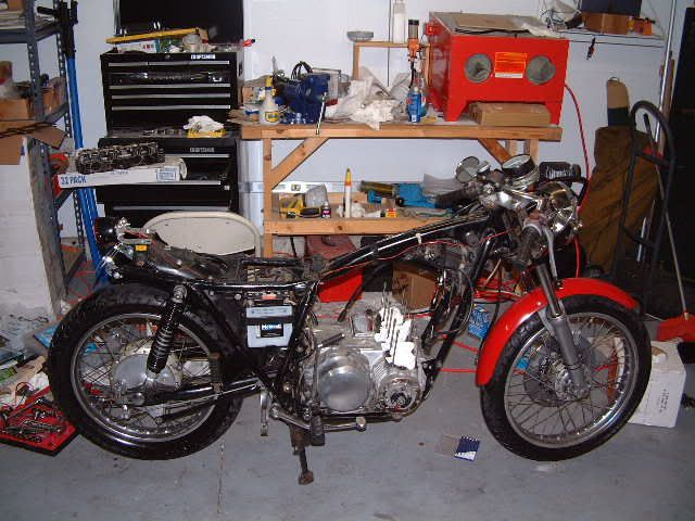

hey CD811 is that your bike in your avatar? where can i see some more pics of it? i know some people have others' bikes in there...cough cough Noel cough...
cd811
Re: Got new ignition,coil,and wires on!
« Reply #6 on: May 11, 2006, 09:21:49 PM »
yea that's mine
there are a few in new gallery
more in old gallery
