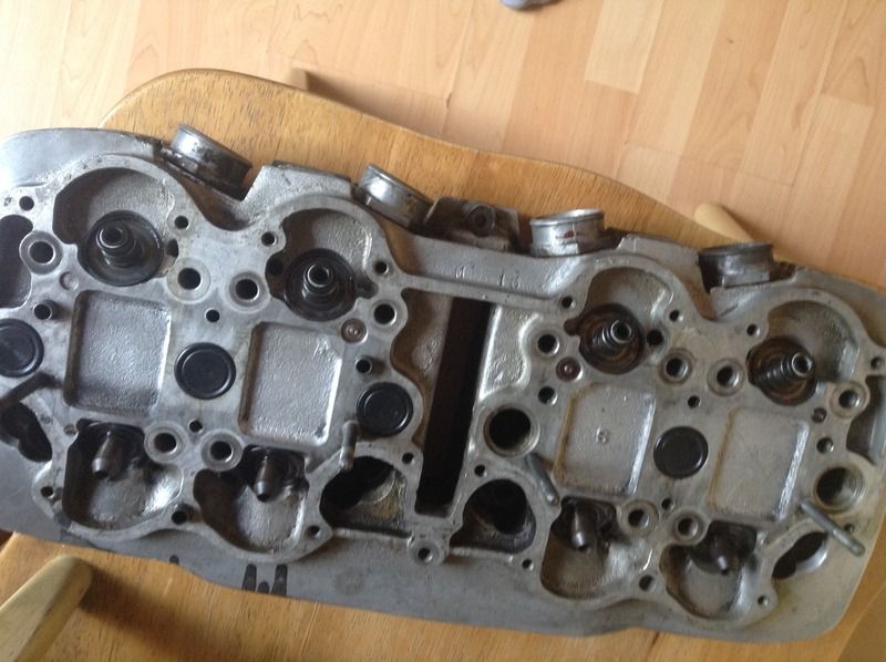

this is a pic of the late diecast ko head,off a known engine,only thing I see diff is a few more markings.
don't have pics of k2,it is not cleaned yet.bill

Offline kmb69
  • Posts: 2,040
Re: ko dicast Q
« Reply #35 on: December 03, 2016, 03:52:17 PM »
Also does not have exhaust valve guide seals. Not sure when the seals were added.
  • Posts: 33,628
Re: ko dicast Q
« Reply #36 on: December 03, 2016, 09:04:32 PM »
Thanks Bill, I'll have to drag my head out and compare it to the one in your pic. Cheers, Terry. ;D
