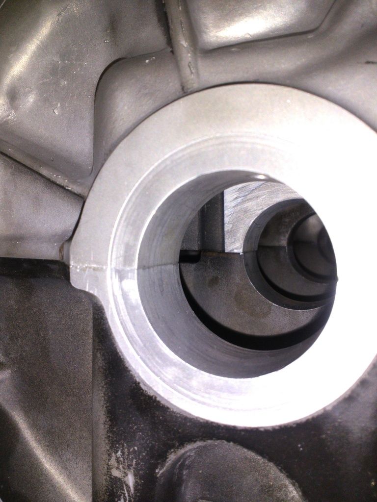

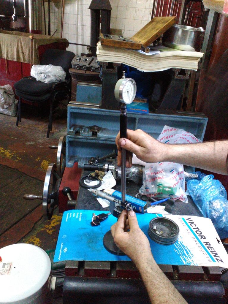

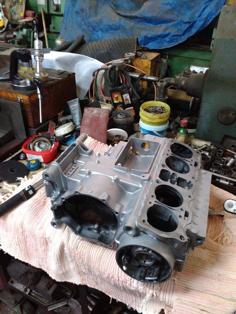

Today I tried to measure crankcase holes for crankshaft using micrometer.
I didn't get to actual measure... but I did measure the difference of 0.03mm in ovalness of some holes. Basically if I measure the hole in vertical(top-down) direction the hole is in specs.... But if I measure a hole in horizontal direction some holes are bigger 0.03mm then in there vertical measurement.
 I torqued all the bolts to spec. I've put some oil on top of bolts... I now that engine lost oil at some point in history but I didnt care because I've got a new crankshaft from cycleX..
Also after some time I noticed that top and bottom cases are not aligned perfectly. I can feel it under my nails(in holes where cases meet) that top and bottom are misaligned by several 1/100 of mm.
All the input is appreciated.

If I understand correctly majority of bikes have this problem and lot of people on this forum are not aware of this?:)
Selecting bearings according to just vertical diameter of a hole(Plastigage ) will work in my engine condition? (0.03mm-0.004mm difference on some holes in vert. and horiz. measurements)
What are the pegged shims ? ("the cases were bored 0.010" and shimmed with pegged shims")
