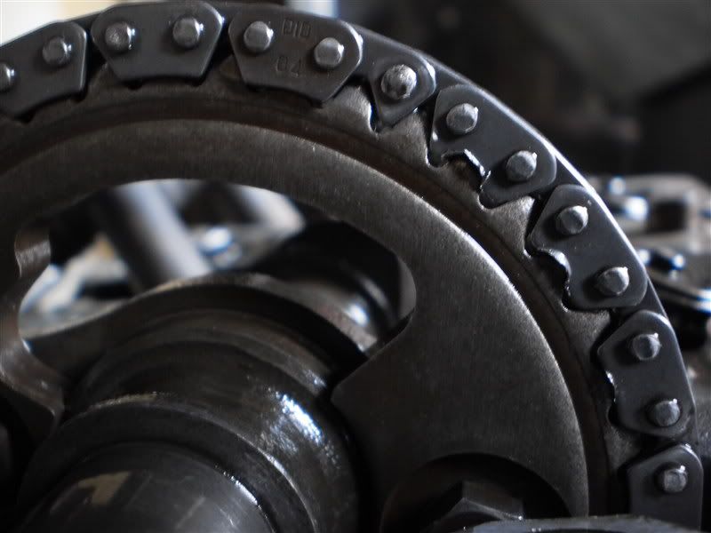

« Reply #15 on: February 17, 2012, 03:21:56 AM »
A friend took his cylinder head to a machine shop to have two thousandths skimmed and they took off two milimeters!
2 thou or 2mm not much difference there, only 78 thou.  As far as mechanic horror stories go I have none, because I am a mechanic and do all my own work, but I do have a couple of horror PO stories, one included my cam chain, where some wanna-be mechanic left an extra link in the cam chain of my 650 and joined 2 inside links together because he was too lazy to back off the cam chain tensioner this caused the cam chain to buzz like mad, which took me a while to pick up because I had heard that these bikes had noisy cam chains and had never really listened to one running, and it wasn't until I lifted one of the tappet covers and found the cam was flopping back and forward, even when the cam chain tensioner was full out.  The additional link also put the cam timing out one tooth which caused erratic idle, hard starting and it would barely crack 140kph.  I was bloody lucky with it though I rode it for 1500km like this before I had crossed every other possible reason off the list of why it was running up to s#!t, and when I pulled it out you could see quite clearly where it was trying to part company with the gears.  Once I had replaced the cam chain the difference was like night and day, on my first ride I cracked the throttle and it lifted the front wheel off the ground by a couple of inches and it easily cracked 165kph and was still able to go more.
