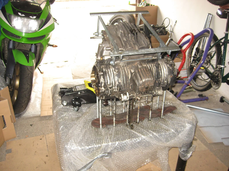

Did not manage to get much time in the garage this weekend : ( I did however manage to (eventually) get the alternator off:
and prepare the rest of the engine for separation.... :
Upside down and ready for separation (I hope) :)

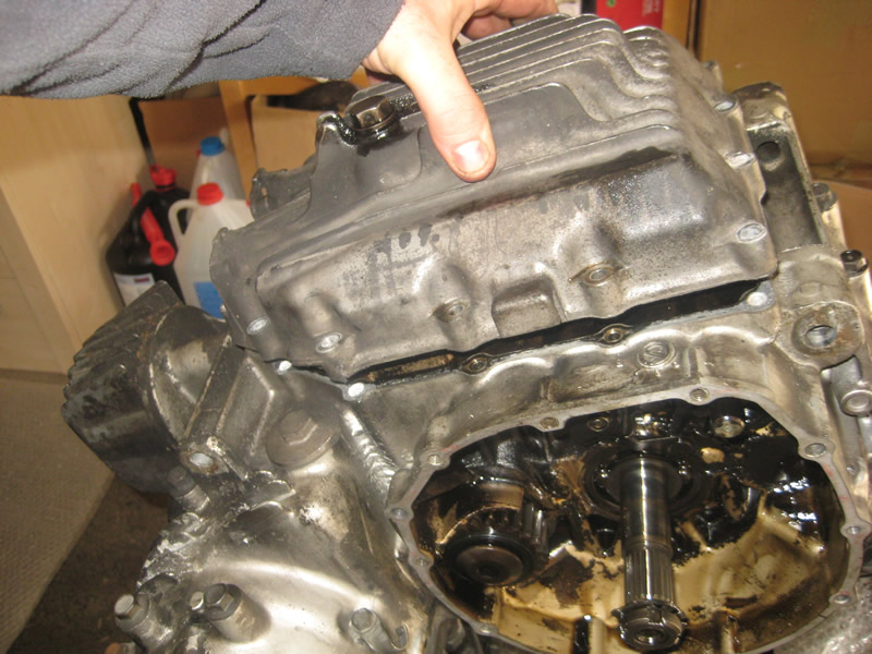

sump off:

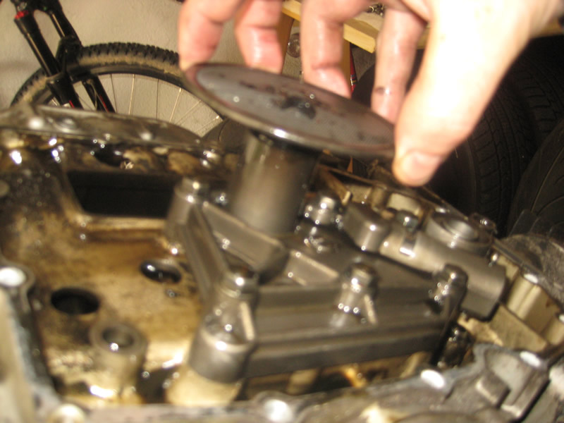

This does not look too good :S
Anyone know how much I should be worried with such shards of metal ???

Removing the final bolts for separation:

Stuck :( the casings do not want to seperate ....
I have tried loosening the seal with both a rubber mallet and also using a larger haller and wooden block, but the seal does not want to break :( I am pretty sure I have removed all bolts (maybe there is one hiding ???).
Would it help to heat the seal / casings up ? would this help the separation ???
As always, any advice is welcome and appreciated.

I finally got the engine casings separated, after heating the seal and using a bit of gentle persuasion with a wooden block and hammer:
Note: if you have any issues seperating the engine, I found heating up the seal very effective... :

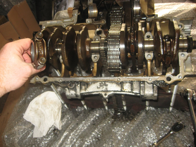

I started removing the connecting rods, camshaft and gear box... and all in all, its looking pretty good condition wise (considering it has what I believe to be a v-hard 60k mile life):

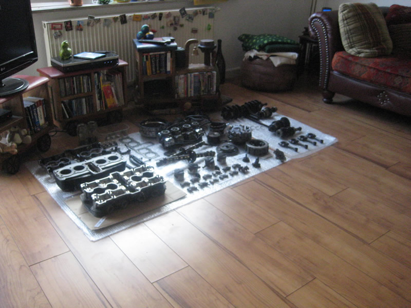

All engine parts now ready for inspection:

The camshaft, camshaft bearing and connecting rod bearing all look in good condition... all are v-smooth with no scratches / marks... I am guessing it makes sense to replace all bearings in any-case just to to be sure - or, is this a little OTT ??? is is worth replacing all bearings even if they appear to be good (remembering thay already have 60+k wear on them) ...
I will be checking all other parts for wear and will be replacing all gaskets and seals... Is there anything else that I should check / renew at this stage of a build... ??? As always any help / advice is much appreciated !!! (this is my first build, so I am still a bit of a novice :) )

So where did the pieces of metal in the strainer come from?
They turned out to be mainly rubber / gummi which I think came from / fell down from the cam chain tensioner as the tensioner was a bit broken / corroded :)
The large piece of metal turned out not to be metal :) It did look and feel like metal at a first glance, however a further look proved it to look more like plastic... I heated it up a bit and it was also flexible like rubber :)

Just an observation, but the bottom case main bearings show wear, they are worn through to the copper layer. The clutch basket is sometimes lose and would make a noise in neutral with the clutch out, that noise going away with the clutch pulled in. Primary chain often makes noise as well. The window on the shifter should be enlarged as per Honda TSB for a lower chance of missed shifts/possible popping out of gear. The exhaust valves should be checked especially on the inside cylinders. Might make sense to build a bigger motor now on your cases with a 900 crank/and a bigger block (1000 and 1100 blocks had better cooling fins)
