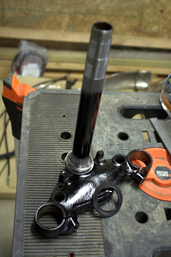

I replaced the steering bearings with those AllBalls ones that everyone talks about. I remember reading in Hondaman's book to unscrew the top bolt and then go find all the bearings that fall. Determined not to have this happen to me, I unscrewed the top bolt sooooo carefully...and then the bottom of the triple tree falls out and I go hunting for bearings. Thanks Hondaman, thanks.
This thing sure makes a loud CLANG when you drop it...not that I dropped it...twice.
Getting the races out of the steering neck (is that what it's called??) was pretty easy. I stuck a screw driver down there and just hammered it out with ease. The hardest part was getting the race off of the triple tree bar thing....if you've done this, you know what I mean. The way I did it was to spray WD-40 in it and then hammer down on a screw driver over and over and over for about 20 minutes. I hammered down on a prybar for the part that I couldn't get the screwdriver to hit. In all of this, I forgot to get pics...sorry.
It didn't look like the old bearings were too bad, but they felt very "chunky" when turning.

The top tripple tree after about 15 minutes of removing paint.
