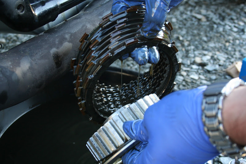

Today we tore the clutch apart.
I packed up all the extra clutch parts I might need. My parts bike was a great buy.
After getting the oil drained the first step was to remove the clutch cover. Once off we have 4 nuts to back out. I went around doing this in 4-5 passes on each screw letting the tension on the springs off evenly.
Once off our first problem was evident. The lock nut holding the clutch basket in had worked its way lose and the clutch basket was moving back and forth freely.
It's not the easiest to see, but our second major problem was the clutch plates were really worn down. See how the clutch on the left has little groves running along the plates, notice the one of the right dosn't.
I have an extra lock nut in better shape so we reassembled using this one and the extra clutch basket. Everything else seemed to check out fine.
So once the bike was back together and full of oil again it was time to see if the clutch was working.
Low and behold its still stuck!!  >:( What's going on here? It's easy to find neutral and push the bike around. Pulling in the clutch lever actuates the arm fine, but the clutch refuses to disengage. We took it to the top of a small hill and by getting a push start can power shift into first and then ride around, power shifting through the first couple gears, but pulling the clutch lever isn't doing a thing for us.
Could we have tightened the lock nut down too tight? Would this prevent the clutch from operating properly? Is it possible we are just missing something completely obvious? Maybe the plates are just stuck together and disassembling them and getting a good coat of oil will free everything up.

Clutch seems better now. We made a stupid mistake reassembling the clutch.
Part #2 was installed behind the basket as opposed to through it. We realised our problem pretty quick, fixed it and also made sure the plates were well coated in oil.
It seems to be functioning fine now, however I'm at the end of the adjustment on both sides of the cable so I have a feeling I stretched it while it was broken and I was trying to get it to work. Its strange because now that I think about it and look at the cable, I'm almost positive this was a new replacement part last year. I must have just been pulling on the lever too hard. The lever is not fully disengaging the clutch, and the bike feels like it is pulling slightly when stopped and in first. I've been shifting to neutral at stops just to avoid burning out the clutch while waiting for lights to change and such. I'll get this replaced ASAP and avoid driving as much as possible.
We tried to compensate for the cable by screwing the adjusting screw in a little more than the recommended 3/4 of a turn out, but now I'm worried that I might be causing the clutch to not full engage while in gear which could also be devestating to my only set of good clutch plates. I can't really test this theory and I don't smell burning clutch, I'm likely just worrying too much but I'd rather be safe than sorry.

Running great now. Slowly putting the km on it as I get the opportunity to go out.
I did have a bad oil seal on the drive shaft. Replaced that with a similar seal and it seems to be working fine. The dimensions for the oil seal I purchased were 36mm inner diameter, 56mm outer and 8mm deep. This ID matches the Honda part, however it's OD is slightly smaller so it popped in quite easily. Also it's quite a bit thinner than the original and doesn't have the metal ring to fit the groove in the crank case. I didn't want another leak so I glued that baby in with a generous amount of liquid gasket and silicon. Wonder how long it will hold before I'm cursing myself for not getting the one with the 58mm outer diameter.  ;)
I've been diligently seeking out a rattle or buzz that I can't seem to get rid of. Seems to come and go sporadically but mainly when accelerating. I think it's just my exhaust starting to get comfy as I've been able to tighten down the nuts holding the header in place. Whatever it is I'll get it eventually, it doesn't sound destructive but I gotta know what it is.
Had the nut pop off the piece holding the pulse generator in place while out for a ride last week. Fortunately it happened while passing my favorite bike shop who were kind enough to let me charge my battery (I toasted it trying to get the thing to start again) while I'll poked around with my tool kit and quickly found the problem.
The Honda toolkit provided with this bike deserves applause. It has served me very well even when I've got a garage full of tools.
I took some time to sand the ugly laser logo off the exhaust.
I'll have to take the camera with me some morning this week before work and stop and grab some photos.
