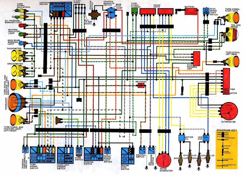

So after mellowing out a bit  8) my dad and I decided to do a little electrical troubleshooting. It was obvious very quickly that I had a short, and with a bit of troubleshooting found a pinched wire running to the alternator. Fixing this the resistance on the short dropped significantly however it was too late at night to test and see if I'm charging any better.
I think I may still have a short though so let me explain what we found. The short completely disappears when I disconnect the connector running from the Reg/Rec with the Black, Green and Red/White wire. I've determined that the short occurs when connecting the red/white wire. According to the wiring diagram this runs to the Starter magnetic switch but I haven't been able to figure out what is causing it. We determined this by disconnecting the positive lead on the battery, attaching one end of the ohm meter to that lead, and the other to the frame. It only appears when the red/white wire is connected.
We also tried testing both my regulator/rectifiers with the meter, it instructed to test for high resistance and low resistance from the yellow wires running to the alternator, with the green and I think red/white(not sure but followed the instructions), I got a high reading on both, but either my meter is too old to get the lower readings or both are not functioning properly as I don't have any reading when I reverse the polarity.
Any ideas?  ???

This should help explain my earlier post.
I guess my question is, should I have an open circuit between the red/white wire on the Rectifier and the positive terminal on the battery, and the ground?
(If you can't read the text, the Rectifier is on the far right in the middle, the red/white wire runs up to the Starter Magnetic Switch, the positive lead to the battery comes off the starter switch.)

I'll have to go through the diagram when I get to a computer (my phone screen is way too tiny).
I wouldn't even worry about jetting and carbs until you get the electrics sorted; a weak spark (caused by low system voltage) will "feel" just like the carbs are cutting out.
