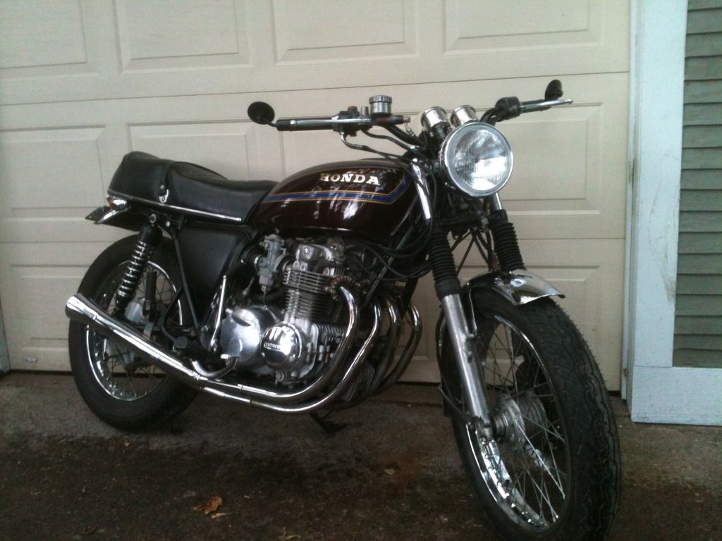

Had a pic on the phone.
-new bars
-dime city cycle- speedo and tach, bar end mirrors, fork gaiters, tail light and blinkers
-new progressive fork springs and rear shocks
-brought in stock rear fender
-Looking to do a a slimmer seat and probably raw metal or new paint job on tank after I fix the dang head shake!

Whoa. What size tire is that on the front?
Offline jmtuccini
  • Posts: 29
Re: CB550 Head Shake
« Reply #12 on: September 17, 2012, 07:16:17 PM »
I think it's a 100. Just looks really big from camera angle.

Nice looking bike. Never take the advice of a shop.... Contact them to ask how much fluid they put in when rebuilding your forks. if they say what Honda recommends, I would question how much is that... But red flag is always when they say what the manufacturer states yet can not tell you how much that is... Maybe the rim is trashed. Even though it can look pretty, may not be good.
