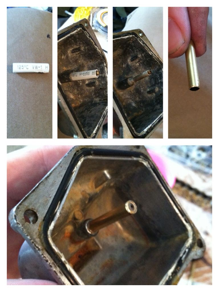

So if you have cracked overflow tubes and have searched the forums for a solution, you are probably familiar with the heat-shrink tubing fix which has been done by others including myself in the past. The problem I have experienced (as have others) is that, inevitably, the shrink tubing soaks up gas, expands, and thus loses its effectiveness.
My solution is really just an addition to the old fix. I found, at a local Ace Hardware, that brass tubing is available in a number of minuscule sizes. It happens that the tube labeled 5/32" (which is the outer diameter) fits quite snugly over a cracked tube which has been covered with regular 18g electrical heat shrink.
Hobby stores (i.e. hobby lobby) also often carry these brass tubes. They are cheap, I got a one foot piece for $1.39.
I haven't re-installed the carbs yet, but the theory is that the heat shrink will not be able to expand because of the brass tube. I will update after I test the solution, but I really can't think of any reason why it wouldn't.

Why not solder up the crack in the brass tubing?  Acid core solder has always worked for me.
Because I (and many others) don't have the requisite skill or equipment (I have been told that my little electrical soldering iron isn't powerful enough)
I recommend you put a piece of the heat shrink tubing in a container with gas, then check the tubing after a month of soaking.  You'll either be happy or sad.
Already did, as the last time I attempted to fix the problem (about a month ago) I used only the heat shrink. It worked for a bit. But like I said, it swelled up and became loose. It did not, however "disintegrate" as phil71 (above) said it would. The heat shrink was still there, in one piece; it had simply deformed a bit, rendering it useless.

Re-installed the carbs and they hold fuel beautifully, its the first time in a while my bike has been leak free. I will let you all know if any leaks appear.
I could have soldered the cracks I guess, but it seems like a hit-or miss solution for the amateur solderer (and I am worse than average at soldering, for whatever reason). The only thing that happens when the heat shrink is exposed to fuel is expansion, just like float bowl gaskets. And just like the gaskets, they dry up and shrink after being exposed to air for a while. However, when prevented from expanding, it seals nicely.
Whether or not it constitutes a "proper" fix is certainly up for debate. I'm sure there is someone out there who would swear up and down that the only proper way to fix a cracked float bowl is to buy an NOS Honda unit.

Spent a few days on the bike without any significant leaking (using an aux fuel tank with no "off" switch for purpose of vacuum syncing, so they were supplied with fuel constantly). Due to mysterious air leaks, I was forced to pull the carbs off again today. While they're off I'll pull the bowls and check on the fix.
