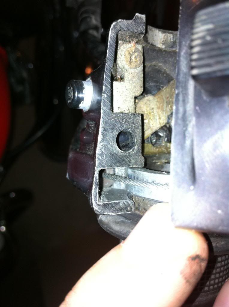

« Reply #27 on: October 26, 2012, 01:36:12 AM »
WIIIHHOOOO
I have now meassured the switchhouse... and there's plenty of space...
Some how the picture i took with meassure ments dissapered :S
I remember the total distance to be 10 mm - 1 cm... And my throttle grip with wire is about 4-5 mm.. så you should have a few mm to bouild up the throttle grip...
I figure im going to order a new plastic grip (mine was metal :S ) and modify that one (dont wanna destroy stock).... I guess the procedure would be building it up, sand it down to fitment..
Any one have any Ideas to what material (plastic) that could work ?
HAHA I Just figured, if you look at the first picture.. where the cable attaches that would be the max radius that fits in the switch housing, right ? :D
