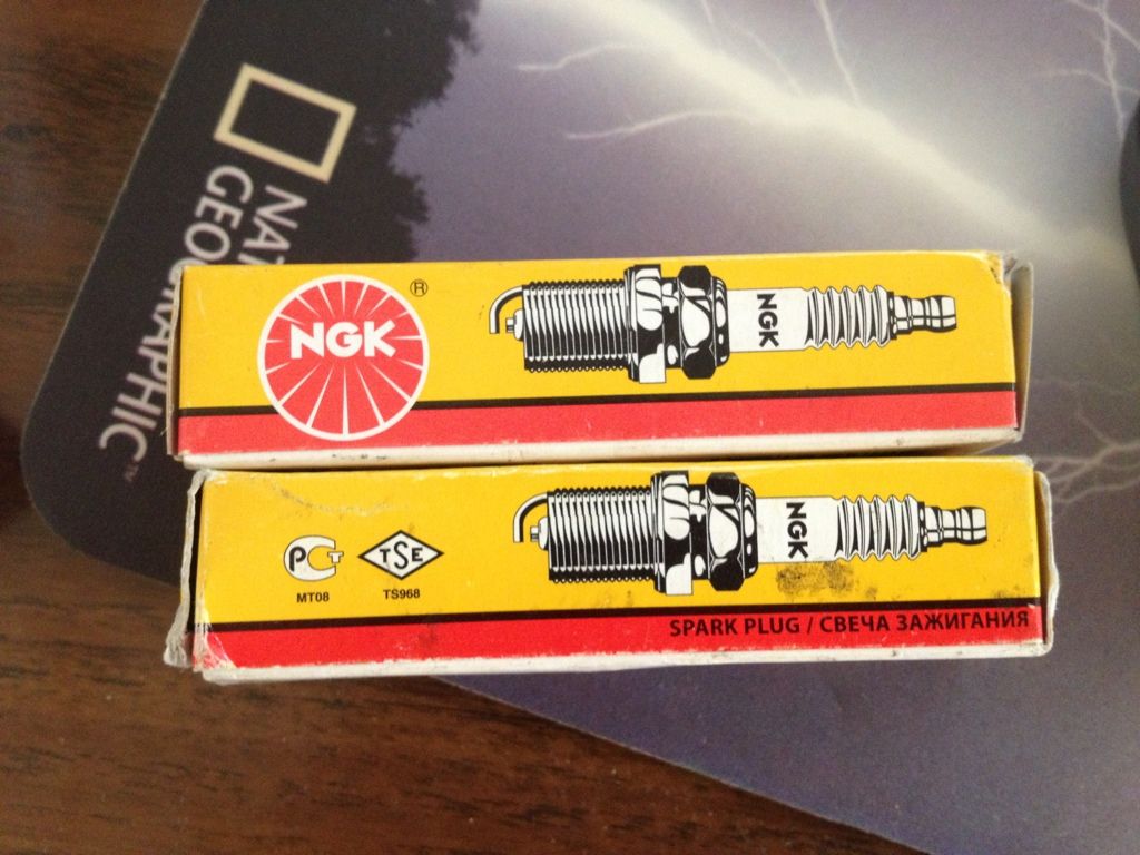

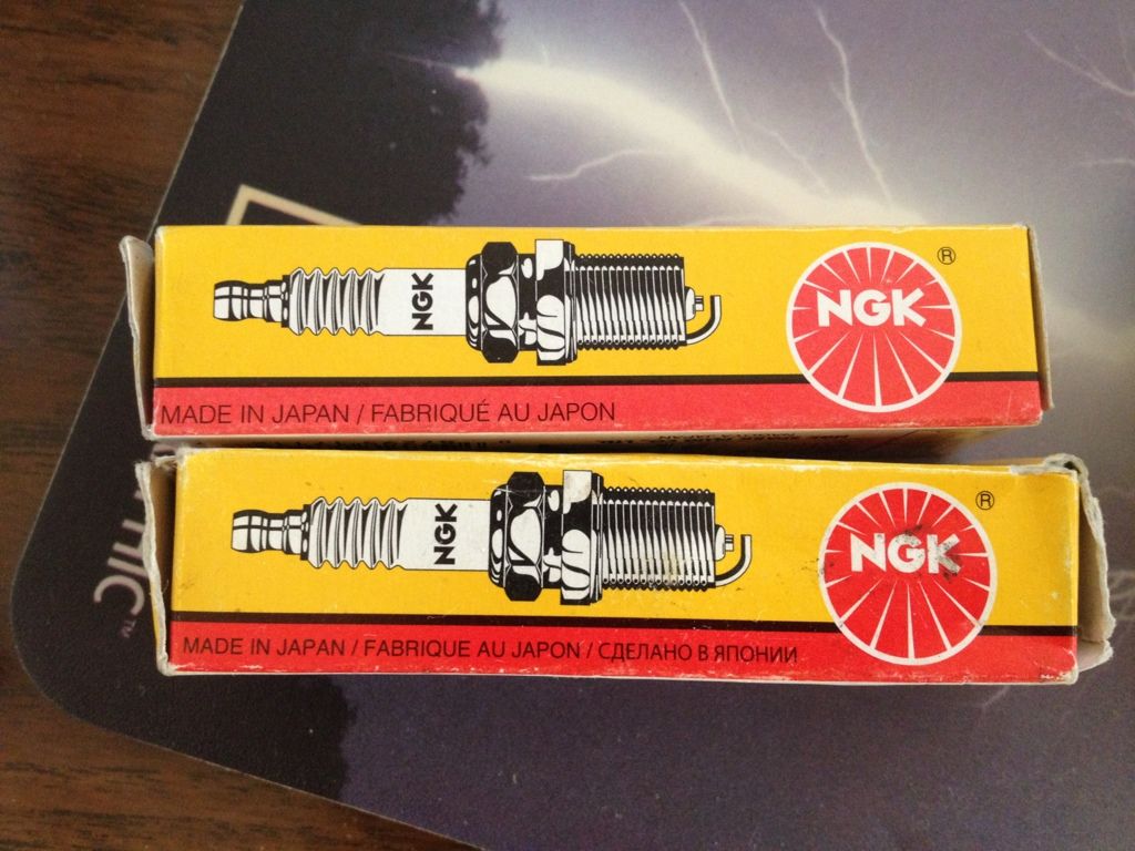

One of a ton of threads about fake NGK plugs. Not that you got any from DDS but jeesh what won't they counterfeit nowadays  >:(    http://www.slideshare.net/athangal/distinguishing-fake-ngk-spark-plug
WOW!  I have both real ones and fake ones...I never would have known...and the D7EA's that have been failing in my 500/4 were all fakes >:( >:( >:(
It seems that the yellow is pretty much the same on both, but I can tell by the missing symbols, and paler shade of red on the striping....this is NOT cool >:(
