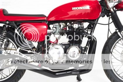

So I always wanted a cafe bike after no less than 43 sport bikes over the years...I found one I liked in St. Pete, FL.
I need to powder coat the Carpy header - it's currently painted and already flaking off. I'm not too certain about the carb settings - the bike is painfully lacking in zero to 1/4 throttle under load - just doesn't like it...but once above a few 2000 rpm it pulls smooth and hard to over 8k no issue. I haven't had carbs / pods / jetting on a bike in forever so I'm at a loss of what to do. I'm thinking pilot jet air screws..but not sure.
I'm fighting an untrue front wheel, likes to send feedback to the bars at about 50 mph-60 mph - I wrung all the spokes and they all played a differnent tune, so I did my best to tighten to the point they all sound similar - I'm close and it made a nice difference, but it's not anal perfect as I want it.
Hate the brakes....but then again a drum and single disk isn't what I'm used too. I downshift a lot to engine brake to help out...I'm sure I could spend thousands in aftermarket upgrades, not sure if it's worth it though.
Also curious about valve tick - I know on some of my older bikes it was more notable....and I hear it on this 550...just don't recall what is "normal". Below is an summary of the bike build from the shop I bought it from, I would very much appreciate any and all feedback!
For those that like a long post - keep reading....
A Honda CB550 is the latest build from Brad Replogle of Cafe Creations & Customs in St. Pete Fl. Transformed; this custom Honda CB550 has received a full restoration while being converted to a Cafe Racer.
The bike started out a couple of months ago as a classic 80s rider, Vetter Rooster fairing, king/queen seat and so on, a real eyesore!
According to Brad “Well as I began to take it apart I saw it was actually very well taken care of and clean under the oil coating from the head gasket leaks. I decided to keep it as stock as I could while doing a Cafe conversion on it.
After a trip to my buddies over at Dime City Cycles to pick up parts it then began. Weight savings were accomplished by removing the stock seat, exhaust, fenders (while retaining the fork brace from the front fender), center stand and replacing the battery with a TruGel battery.
The engine was disassembled, painted, polished and resealed with new gaskets. The carbs were detailed and rejetted to match the old school velocity stacks and the header from Carpy. This may be one of the best sounding 550′s on the planet thanks to that exhaust. It is light weight, baffled and patterned after an old Yoshi system. While the polishing wheel was running the front end was polished including the fork legs, caliper and mount, top triple tree, master cylinder, as well as the handlebar controls.”

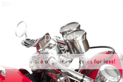

The front end of this Honda CB550 was reassembled with progressive fork springs and using classic clubman bars, mini gauges mounted on aluminum mount from DCC. The turn signals were replaced with mini billet units; the front lighting is new including all trim rings. DCC’s new fully indexable rearsets were used in conjunction with the bars up front to give it that racer feel.
The seat is a Thruxton unit from Legendary-Motorcycles, it also uses their integrated pad system. A mini cat eye taillight brings up the rear. A stunning red paint job was applied to this custom Honda CB550 including the stock side covers that often get left off when doing a bike like this. The headlight shell sports the same to brighten the front end a little further.
All the stock electrics remain intact including the harness which was in great shape with the exception of the ground circuit. The finished bike is a classic transformation from Cafe Creations & Customs, red and black on this bike is a hit! Here’s your chance to own this custom Honda CB550
