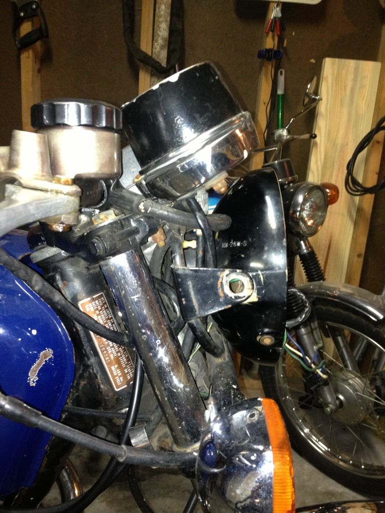

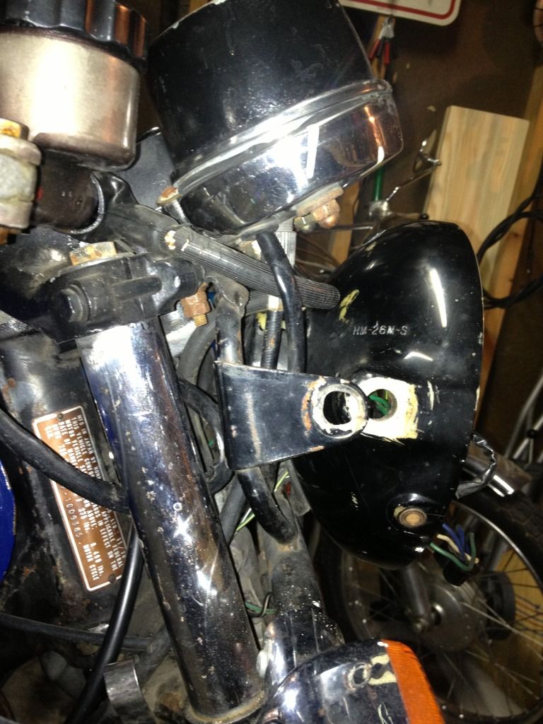

Mr powderman or anyone else with a 400. Please please please
Could you please, for all things cb400f, look and see if your headlight bracket is strait? Mine has a bow in it. Im also having trouble getting the beam to aim properly. Mind looks like it was pushed in. The back of the bucket hits the bottom of the ign switch. I cant get the bucket to point down far enough? I Just came back from a ride and all the signs were bright as day. Lol.

you olso need a new brake hose  :(

Looks pretty obvious that someone stuffed a 7" bucket (prob from a 550 or a 750) onto your 400f for whatever reason. You can either send back the bulb/reflector and exchange for a 7", or try to obtain an original 6 3/8" housing.
