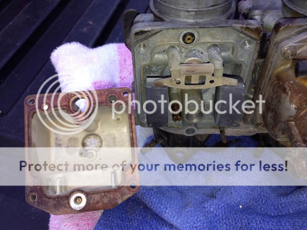

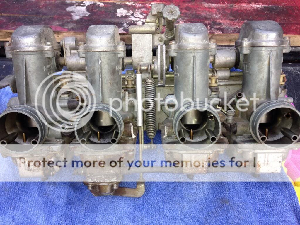

I went to a vintage bike show two weeks ago, there were three Z1's there, all '73's.  I like the '75 paint scheme better and that's what I will be going with, plus mine is a '75.
Anyways, they had a small swap meet at the show. I missed getting 2 Honda tool bags for $10 by one minute! [both for $10 and one was like new with tools].
Missed out on those but got a rack of Mikunis for $10, didnt even have to negotiate! The slides were stuck but after spraying some WD and letting sit for a couple hours they are not stuck anymore.  Kinda dirty, I've seen a lot worse, but for $10, WTH?
Now a question for you Mikuni experts: How do I measure the size? I'm guessing they are 26mm...
Pulled a bowl...looks like they were drained.

Steve-O, those look just like my Vm28ss carbs, although I think there were 26mm pumpers too that probably look much the same...read somewhere that vm28ss were second only to 29mm smoothe bores as far as performance potential
The early Z's had the 28's, then they switched 26's for easier tuning.
I dont see any markings on these. Can you please look at yours next time your at the shop?
Z1 carb ID...
http://www.z1enterprises.com/Z1CarbGuide.aspx
Mine look like the 26mm but have four screws holding the float bowl on.

vm28ss are different from earlier vm28sc in that they have an accelerator pump circuit (kind of a dead give away).  That link does not cover these carbs.  I think they were first used on 78 or 79 Kz1000 ltd...until '81 or so?
On the #2 carb bowl?  These have although parts are missing.
yep, also you can see the pump spray jets sticking up in the mouth of all four carbs.  The pump circuit works about the same as the one's on the f model pd's.  I have cleaned mine and fiddled around but have not got the pump circuit to work yet as the pump diaphragm is hard and wrinkled and I have not put much effort into finding a replacement diaphragm yet.  Also, the pump circuit can apparently be disabled by swapping to standard float bowls and re-jetting.  I have an extra set that I would like to try on a big bore cb750, if I can manage to find workable boots someday.

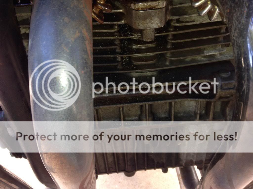

Started cleaning the motor yesterday....
better, but still not done....
Before:
After...
It was really nasty, there was an oil leak from the tach cable. I replaced the seal.
I debated whether to paint the motor or not, really need to pull it to do a proper job. I'm not going to pull it just for paint, so this will do for now.

Ha ha, the old "Rattle Can Resto", I've got an engine here that someone did a similar job on Steve, I only hope that yours is in better condition internally........... ;D
I realize it's not a proper paint job but at least it's clean now and ready for some new pipes!

I assume yours is a Z1-B, so you should look for 28mm carbs. Those carbs above seem to be Z900 26mm.
