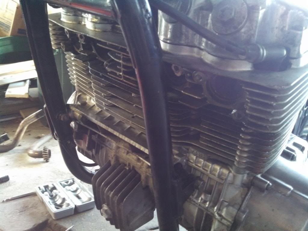

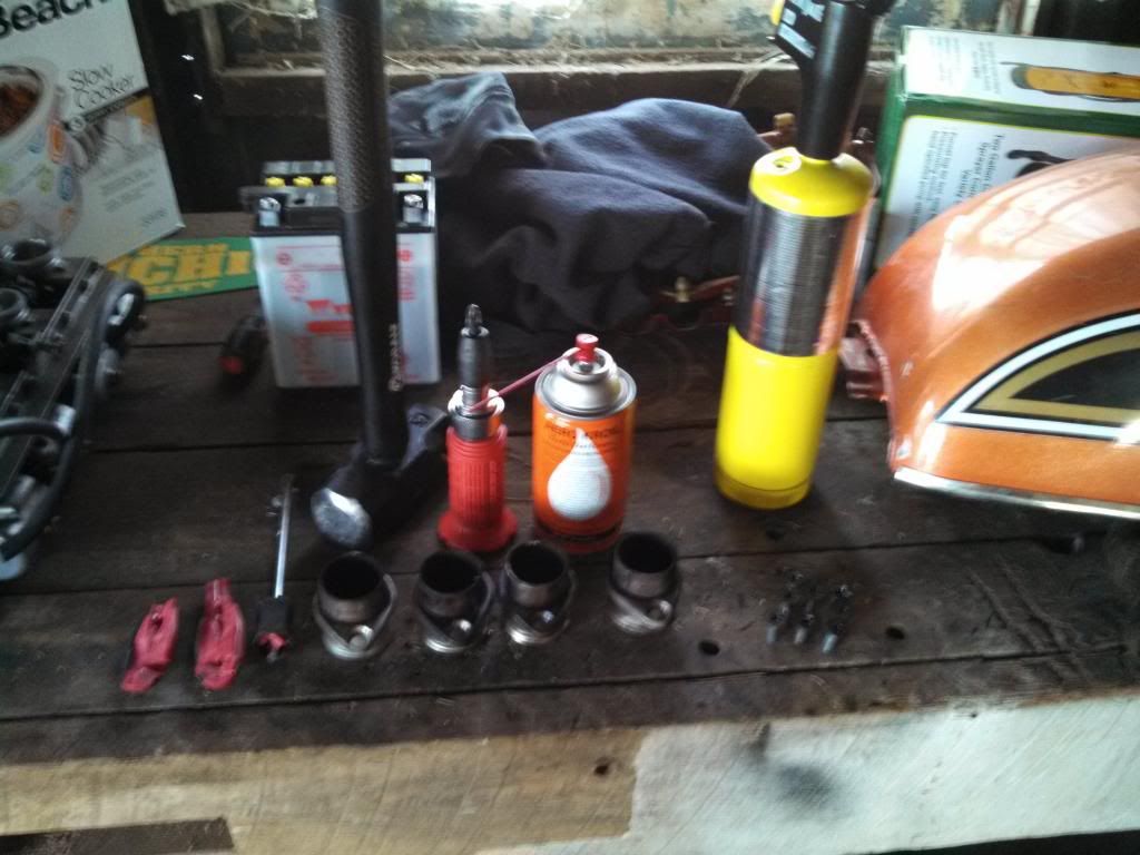

Thought I would give everyone who gave me good advice an update....

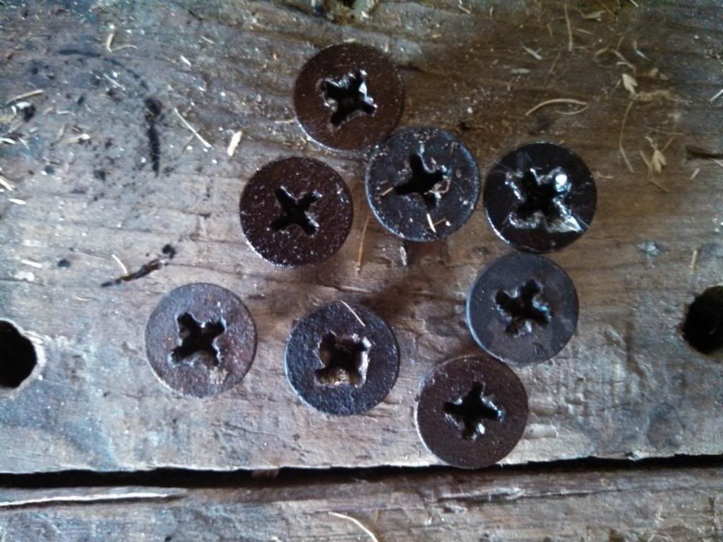

After about six hours and lots of heat, AeroKroil, hand impact driver, banging, and cussing... SUCCESS!
Got them all out with only real trouble from a couple that were getting pretty rounded and chew up. Once they broke free it was no problem, probably could have backed them out with my fingers...
Here's a couple of pictures.... Got all the parts for the new exhaust, so as soon as I can find a couple of hours I'll get em on... May actually be riding this summer....

Be nice to chase those threads a little with a tap and die set if you had one to clean them out well. Are you running studs or bolts on the new exhaust ?

Shortened.......
Were you using the correct size phillips bit?
Did you use a #2 or a #3 bit?
Did you know that the impact driver must be preloaded, (twisted) in the direction you want to go before striking it with a hammer?

Next time you use the impact driver put the bit in the screw,press down and turn the driver in the direction you want to go and the hit it with the hammer.
Some people do not know any better... and just put the impact driver on the screw and hit it with the hammer. That always strips the screws.

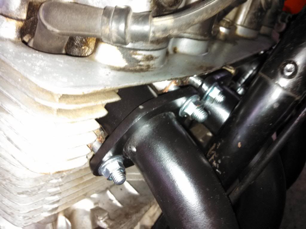

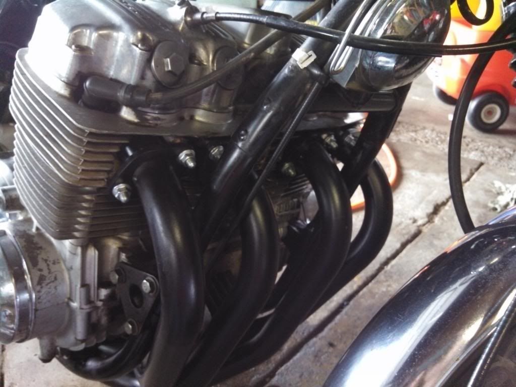

So lets put the thread to bed once and for all....
Everything is nice and tight. Torqued the bolts good and hard but I'll check them once I get it fired up and moving down the road.
