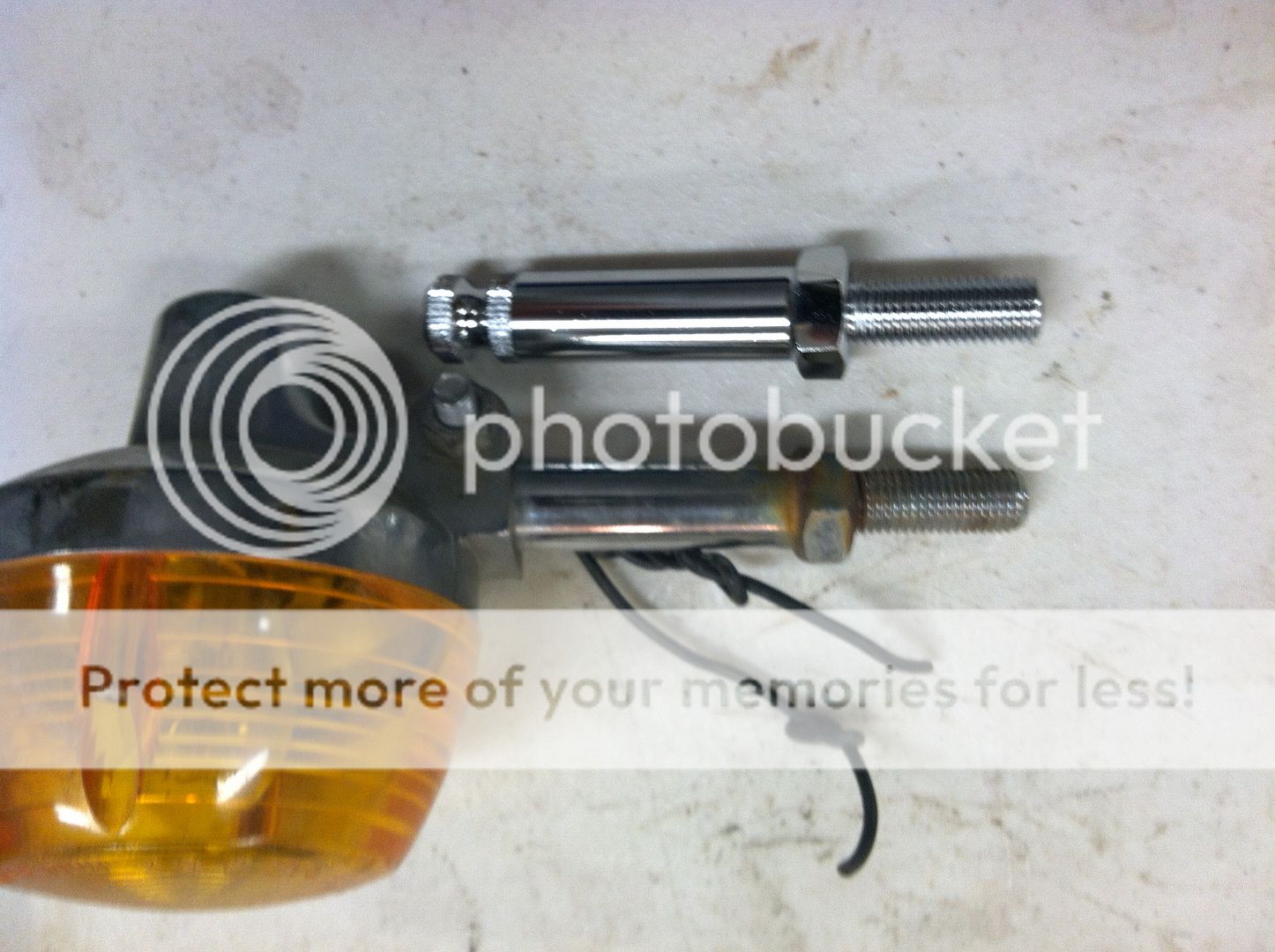

I just got new turn signals and front stalks from partsnmore. The bike is a 750 k3. The first pic is the new stalk compared to the stalks from my other bike (k4). The second pic is the new stalk compared to the current stalk on the k3. You can see that the new ones match the k4, but are much shorter than the ones on the k3. So my question is are the current k3 stalks on the bike in the second pic the wrong ones? They are rusted and pitted and i want to replace them with the correct parts for the stock bike. Thanks for any help.
1973 Honda CB750 Flake Sunrise Orange
1974 Honda CB750 Flake Sunrise Orange (In Pieces)
1995 Ural Tourist
2005 Honda 919
  • Posts: 12,569
Re: Front Turn Signal Stalks
« Reply #1 on: June 07, 2013, 09:04:25 PM »
They come in different lengths. Looks like you bought a pair that are too short.
The replacement parts (aftermarket I have seen) also don't have the taper of the stock ones. The metal on the stock ones gets much thinner toward the ends in the stock ones whereas the aftermarket ones tends to be thicker walled. At least for the pair I had bought.
Rear ones have the different base on my 550...

« Reply #2 on: June 07, 2013, 09:05:08 PM »
This is a K4 OEM
It's the short one

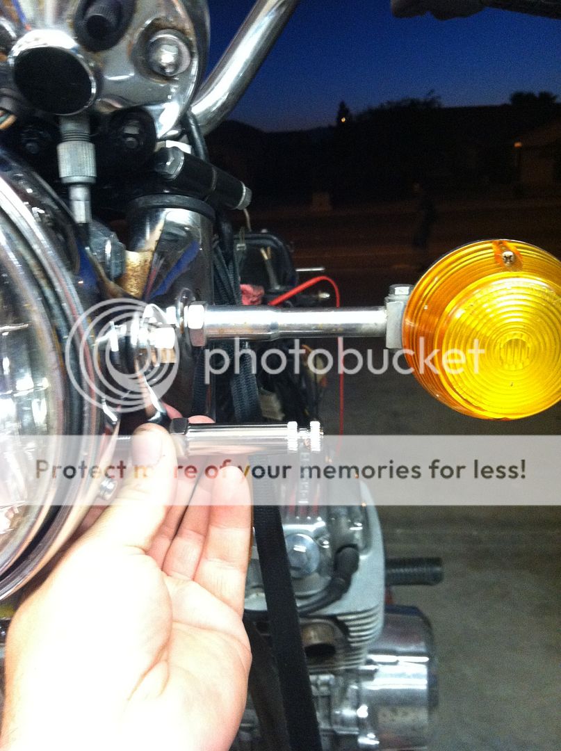

« Reply #3 on: June 07, 2013, 11:14:06 PM »
ok thanks guys. just so i'm clear (the pic is hard to see) the stalks that are on the bike in the second pic are the correct k3 stalks? the new one that i'm holding in that pic are not right? i know they will work. i'm just trying to make it correct. does anybody reproduce these? i can clean mine up, but they have deep pits in them. i can face the pits downward to hide them a bit. i've looked on ebay and most look worse than mine. thanks again.

« Reply #4 on: June 08, 2013, 01:14:12 AM »
your short stalks are correct for the US. Use them.

« Reply #5 on: June 08, 2013, 07:51:00 AM »
got it! that's what i was hoping for. any idea what the long stems that are currently on the bike are from? the only evidence of this bike ever going down is some rash on the front bottom of the #4 pipe just behind the bend. but they are not the original pipes from this bike. the fork ears don't have the slightest ripple to indicate that the original stalks were damaged in a crash. the turn signal housings look original.  i know it's 40 years old and there's no telling what happened in that time. just curious. maybe the longer stalks were to clear a fairing or windscreen at some time? thanks for the help!

« Reply #6 on: June 08, 2013, 08:05:12 AM »
I think yours are original,the long tapered ones. I have a couple of original 73's 750's down at the shop and will take a peek later today. In some pics I have they look like the longer but no close ups and I can't remember. Will take my camera down to verify.

« Reply #9 on: June 08, 2013, 11:40:23 AM »
The CB750 K3, K4, K5 and K6 all use the long tapered or stepped front turn signal stalk design. Honda part number: 90154-341-670. The long stalk in your photo below is factory correct. Click/double click on parts diagrams for largest view.
