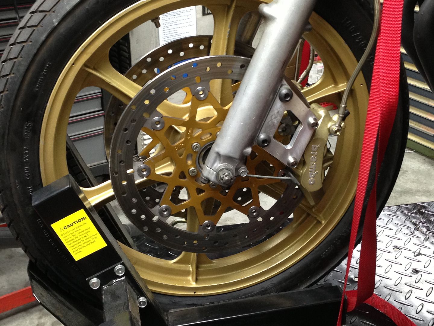

this is my set up using 6 pot calipers, I had to machine the back side of the calipers to clear the spokes (I tried to match the angle of the spokes)
so much that I machined into the piston pockets. its nice to be able to just weld them up but there is not
a lot of room left. The front end is a GL1000 and the rotors are from an RC51 Honda
on the other hand I machined the mounting tabs on the forks to move in the mounting plates to make these work
320mm brembo rotors using EPM wheels
