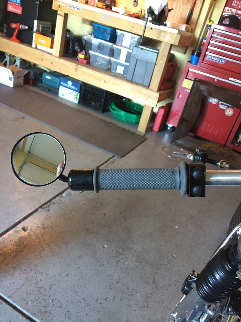

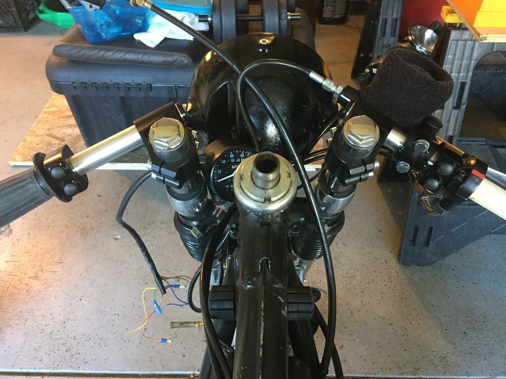

Ok I'm done geeking out on English words. I mocked up the controls a bit just to see what things would look like. Had to slide the MC in a bit more to fit the m-switch on that side. I'll have to order a new upper brake line.
Worked on sanding the clamp a bit more as well.

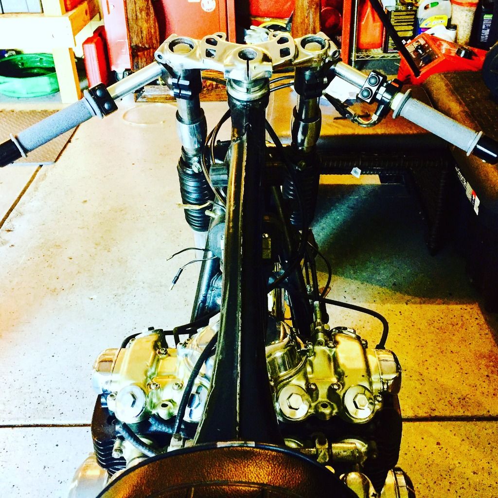

After days and days of sanding, I finally started polishing the top clamp last night and finished up today. There's a few spots I'm not happy with but I think that's more an issue with me than anything else.
The old mirrors broke when I removed them (really weak pieces that were inside the bars) so I had to order new ones. Got the grips and mirrors installed today. Can't get over how clean the left side looks right now. Obviously, the clutch lever isn't attached in this picture.
Front end is getting there. New MC should be here soon and then I need to order a new brake line. Might also be ordering a new clutch lever. Still marinating on that.

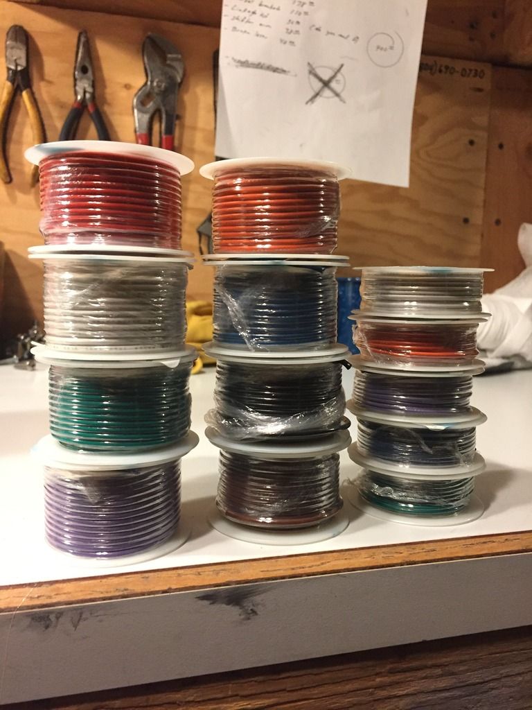

And this showed up tonight.
Still need some small stuff like proper connectors and a crimp tool. Crimpin' aint easy yo.

Hot damn, those bars are looking good with the new switches.

 What is the clearance looking like on the right handlebar and tank...throttle cables may need rotated down and away to add clearance for tank.  It looks like they are rotated towards rear and down rather than down or front and down.

David...good eyes. I haven't had the tank on the bike in a bit and everything is loosely tightened right now because I still need to move things out of the way and drill the bars for the m button wires. I drilled the steering stops and installed limiting screws long ago because I had to use them with the Tarozzi bars.
