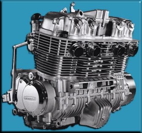

Still need photos of an engine out of the frame.
If someone does this for me, I'll make the 3d file available for everyones use.
No.

« Reply #73 on: August 28, 2006, 02:54:16 PM »
Fantastic. I could really use a straight head on shot and straight down shot (from the top) as well, but this will get me started.
Thanks!
No.

« Reply #74 on: August 28, 2006, 02:55:21 PM »
Hmm, those 'f' shots look like dohc...
But i ahvent seen an f engine in person...
No.
