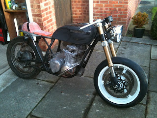

Offline ISLAND CAFERACERS
  • Posts: 46
had to put the build on hold for a few weeks while we move to a nice little cottage with land & more important some decent size outbuildings to turn into 4 workshops!!
its on the island of Anglesey off the coast of Wales in the UK
1st job put a front onto the old stable with windows & a decent wide stabledoor
I used the old planks from the original doors should look right when painted
here is a view from inside its a decent size & when kitted out with a log burner a snug workshop
looking better with a couple of coats of paint
and heres the project sitting better now with bars fitted I will post a few more images in the week
cheers all Andy

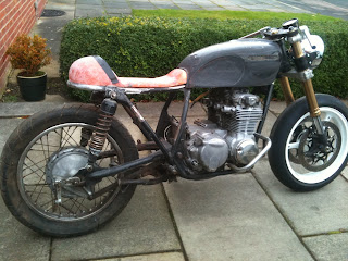

Hi all
fitted the bars now & dropped the headlight down & back an inch
also fitted a tacho
I think its sitting right now - next job is the spoke front wheel
keep you posted

Building another CB550 cafe racer with USD - SITS BETTER NOW WHAT YOU THINK?
« Reply #54 on: December 14, 2013, 08:10:22 AM »
Hi all I have been off the site for 18months or so, I had to rejoin as had lost all details, I did a build thread for my CB550 café racer
now its time to start again - just bought another runner on ebay - quick question I love squirelys café & will use some of his ideas on the new build I am working through all his threads but does anyone know what forks he used I know they where GSXR but no more can anyone let me know if they where 750 or 1000 or if they are the same
good to be back will keep you posted Andy

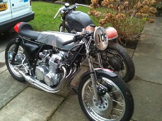

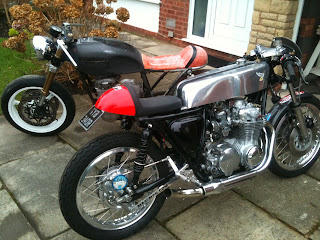

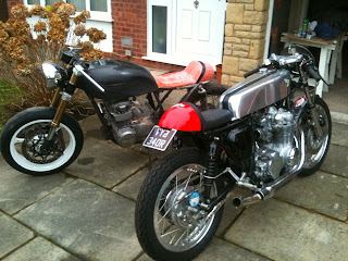

  • Posts: 46
collecting parts to move forward on the build, ran up my other Café CB 550 this morning & took a few snaps of the 2 bikes
Café CB550 started 1st time & ran round the block nice & strong
old school & new school styles what do you think ?
have a great 2014 Andy in the UK
