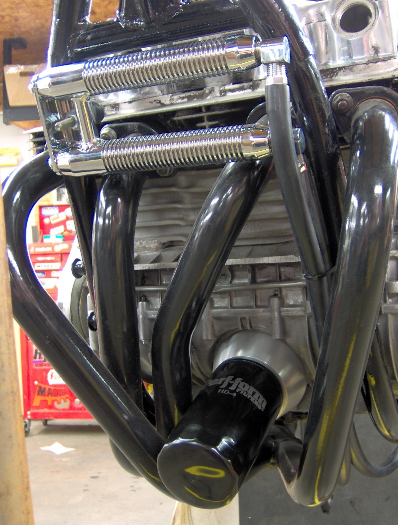

This is a Lockhart "Upside Down" cooler on my bike, with one of my adapters on the engine. Cheers, Terry. ;D

Hi Chaps, where do i find an adapter like the one in this pic? What oil filter is used?  Thanks
Offline Tintop
  • Posts: 3,970
Re: Oil Cooler for CB750
« Reply #18 on: May 06, 2014, 06:31:21 AM »
Contact Terry in Oz ( http://forums.sohc4.net/index.php?action=profile;u=25 ) he can make you one.
