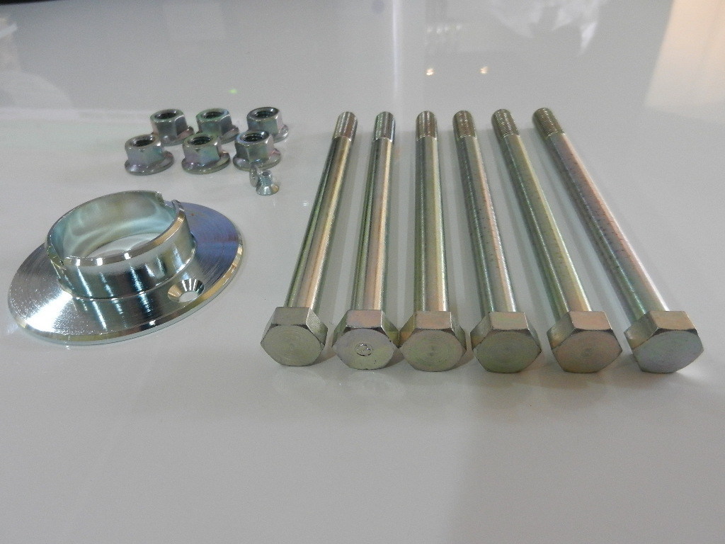

Wobbly:  i see there is a speedo drive adapter there, but what purpose do the bolts serve? Are they simply longer to allow bolting 2 discs to the hub or just new bolts? I plan on mounting dual 750 discs and brakes on my 550.
1976 CB550K            1979 XS1100
1980 CB650C - Sold
It's a little motor and likes having the tits revved off it.
Re: Dual Discs - lower pipe
« Reply #20 on: February 23, 2015, 01:28:07 PM »
Yes, longer bolts for the added disc.
the posted adapter can be used instead of modifying the existing speedo drive plate, or routing out drive plate holes on the rotors carrier.
