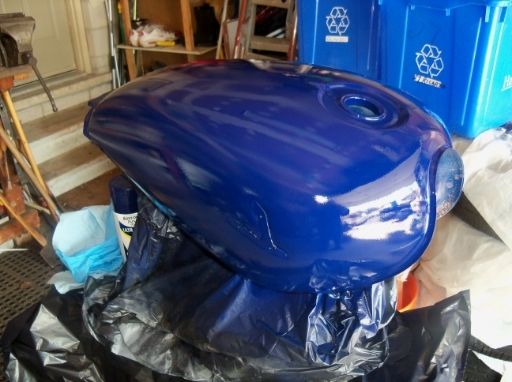

Being a frugal (cheap) Scotsman I have adopted the rattle can paint job with 2 k clearcoat as my favourite method of painting. I prefer solid colours like black, white, silver and now dark blue and a $6 can of Rustoleum works just dandy. While I had been spraying two part automotive finishes I find this method easier and cheaper.
Up until just recently, I would lay down the base colour and spray the clear with my HVLP rig but I recently found my local CARQUEST now carries 2 part clear in a can so I will be trying that out shortly.
On my CB I am going with a dark blue and I will lay down a chequered flag graphic on the tank sides and side panels. Here is the tank as it sits now waiting for the graphic
Now I have done 4 or 5 bikes this way and all turn out well but I don't  recommend this for frames and engine parts if you can afford the cost of powdercoating. As mentioned it is a better and more durable finish.
For new painters or those on a budget this method works well IMHO.
