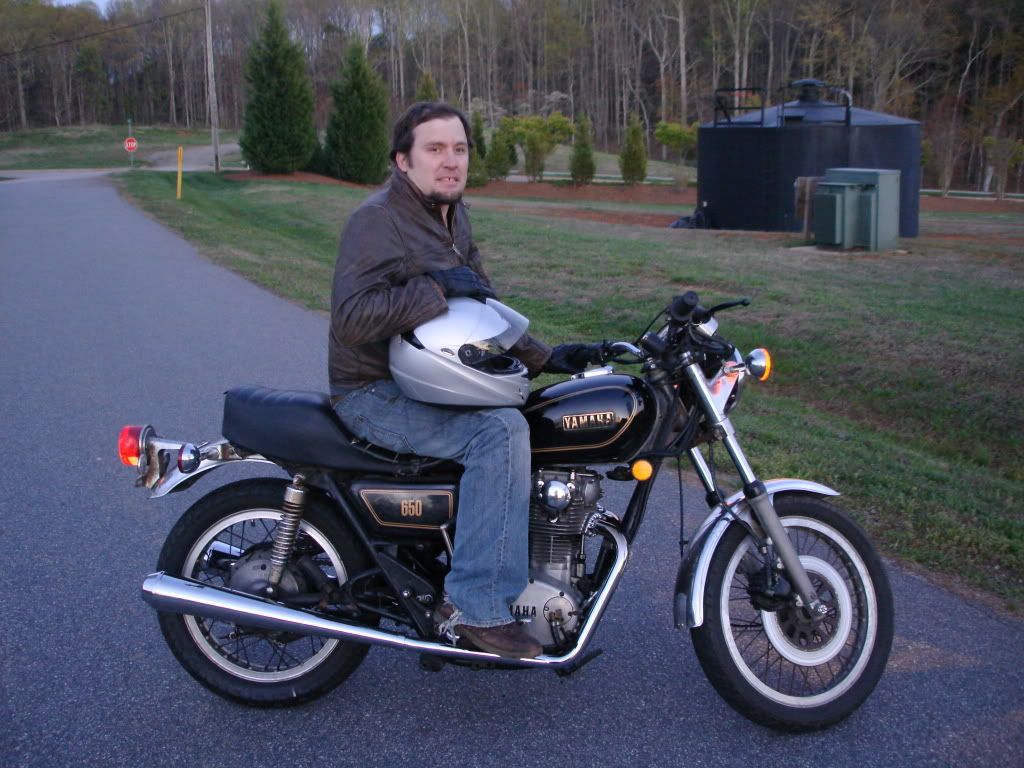

Hello Pete! First it got some new pipes as the Kerner that was on it had given up the ghost . The salty beach air explains alot!
Pardon the facial expression it was like chilly 35 degrees out if I recall Lol, .
I rode it like that for maybe a year and then she got a makeover-
Attached is a pic how you Prolly remember it and then after a year or so it got caffinated. I still have your seat!!!! If you want it for nostalgia let me know :-).
I sold it to some banker in charlotte 6 years ago for a ridiculous amoun of frogskins. I have seen it up for sell on craigslist once since then.

As you can see your rubber mounted oil pressure gauge made it through the transformation lol. Was a great bike for me and even with a "tired" engine I never noticed compared to other xs650 s I have owned and ridden. The wiring was really "interesting" lol. Relays upon relays ...Thank good you were kind enough to print and store a modified schematic under the seat for your improvements.:-)
Thanks for sharing I enjoy herein bikes histories and we're they had been. That one was a school bus for me . Way cooler than riding the cheese as a child though!
