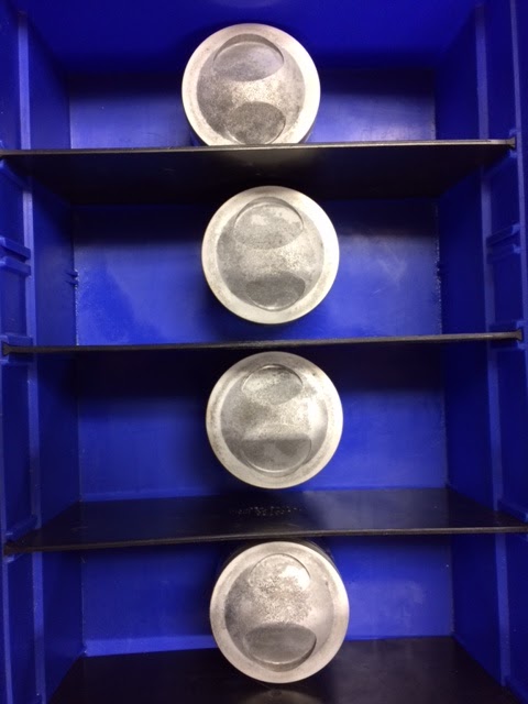

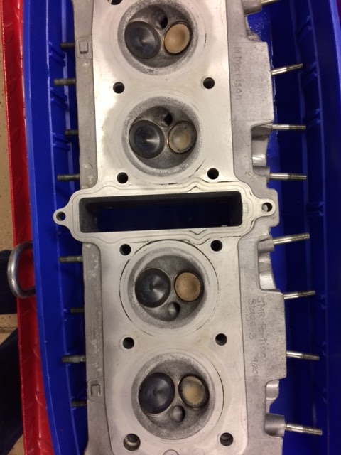

Soda blasted the carbon off the piston and head this morning.  Found some minor pitting.  On the pistons it is extremely light.  The head is a little grainy, but again very light.  Found similar, but much heavier damage on my old head and pistons.
Trying to figure out what is going on.  I have been using the "F" mark on the advancer to set ignition timing.  I did back the timing off after ruining the last head thinking it is detonation.  Since the damage is much lighter I may be on the correct track.  I do not use a degree wheel so can't confirm if the marks on the advancer are correct.  Pretty sure I can continue to use the head and pistons, just don't want it to get any worse.  Has anyone else seen similar damage?  What are you timing your spark at and are you using a degree wheel?
« Last Edit: December 23, 2017, 09:21:23 AM by Rocketman »

 That grainy appearance is probably due to running open velocity stacks. Small particles of dirt get in the cylinders and pock mark chambers and the top of pistons.
 I think this would be a good opportunity to smooth the domes with a fine Scotch Brite wheel or polishing wheel. Tape the sides of the pistons and HOLD ON TIGHTLY. A light bead blast to the entire piston (with the ring grooves taped over) is a good idea. After that I'd have the domes and skirts coated.
 You clean clean up the chambers by carefully using a blue cross buff with a mandrel (you need some junk valves in there to protect the seats/valve job). You have an OS intake valve so that makes it a little more tricky when it comes to a junk valve.
« Last Edit: December 23, 2017, 09:34:51 AM by MRieck »

Thanks for your thoughts Mike.  Will need to investigate air cleaners.  Don't want to go through a head and pistons every year.

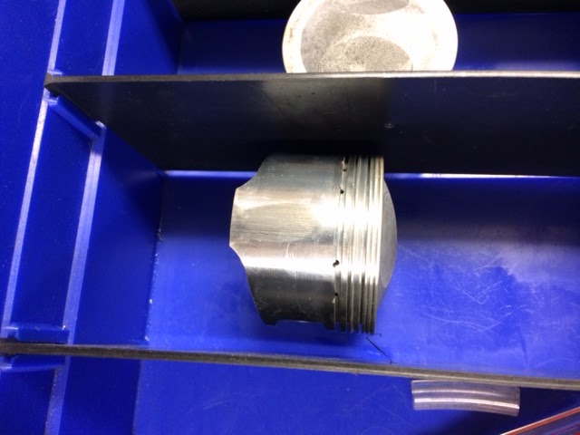

 I see more skirt scratches/bore marks when fiber clutch plates break apart. I have seen similiar condition on my on parts after running individual K&N's on the street for several years.
 I don't know what type of ignition Martin is using but switching to something more modern would get away from that mechanical advance and have a more reliable advance curve. He should be packing all his timing in around 3500 RPM with about 36 to 38 total degrees given the small bore. Brent and Turbo are using the GSXR ignition which has proven to be a great performer and very reliable.

Sounds like a couple projects over the winter.   :)  Took a closer look at the pistons and all are scored on the front/back thrust faces.
I think Mike is correct regarding dirt entering my open velocity stacks.  Not sure if these are salvageable or if new pistons is the way to go.  Have both glass bead and vapor blasting available.  Mike, what coating are you referring to?  Will also investigate options for a digital ignition with advance.  Sounds like GSXR is a proven alternative.

You can send those pistons to Line2Line coatings, give them your bore sizes, and they coat for zero clearance. There is a specific break in procedure they give you, and they wear in to correct clearance. Your pistons should be coat able like that, why don't you contact them and see what they say? It's about $35 per piston.
They have a testimony by a racer who uses this coating on his FZR400 racebike, and it really helps preserve the pistons and bores.

Swaintech does something similar with their PC-9 skirt coating.  Nice people to deal with a well.

 I have used Swain Tech many times but Charlie's suggestion is good too. You can smooth the thrust surfaces on the skirts with some 400/600 wet dry paper, bead blast and than coat. As Charlie stated...it will build up the surface and tighten up skirt to bore a bit. Nice low friction surface. If you Nikasil the bores the friction is reduced further and your bores will really never wear out.....it is very hard stuff.
