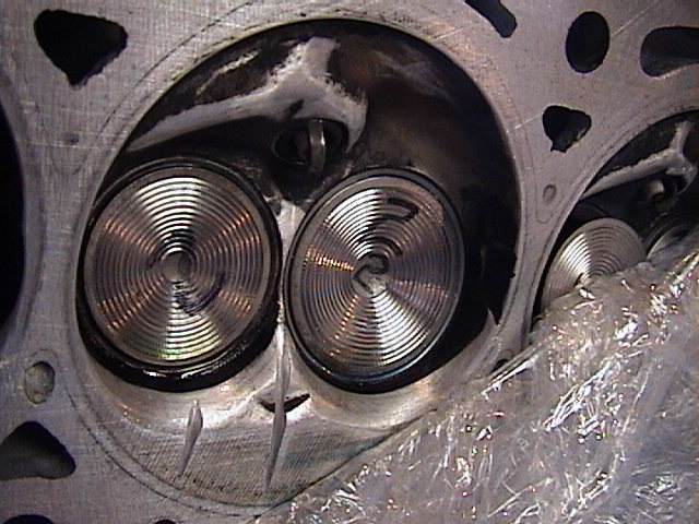

If you want to continue using your little 350 as a highway ride, you may want to consider upgrading certain components to help the engine resist detonation.
Everything that kghost said is true, no matter the engine you're working on. One thing that is especially important is getting the air/fuel mixture that is in the chamber as homogeneous as possible. There are a few "tricks" that have been developed since these engines were made, many of which aren't very well known.
Two things I recommend: MetricMechanic's Surface Turbulence valves and Mike Holler's PowreLynz.
Surface Turbulence Valves:
http://www.metricmechanic.com/pdfs/M3_Engine.pdf
Before you say something like "That may work with car engines but it won't work with our old motorcycle engines," do a little research. I know that this particular picture is of a completely different combustion chamber (utilizes squish/quench and Singh Grooves) but the effect is the same regardless of the chamber shape. The ST Valves help mix the air/fuel before it gets into the chamber.
The back side of the valves look the same. They will increase low-lift flow by about 10% and full lift flow by about 4%. They also aid in vaporising and mixing the fuel into the air charge.
