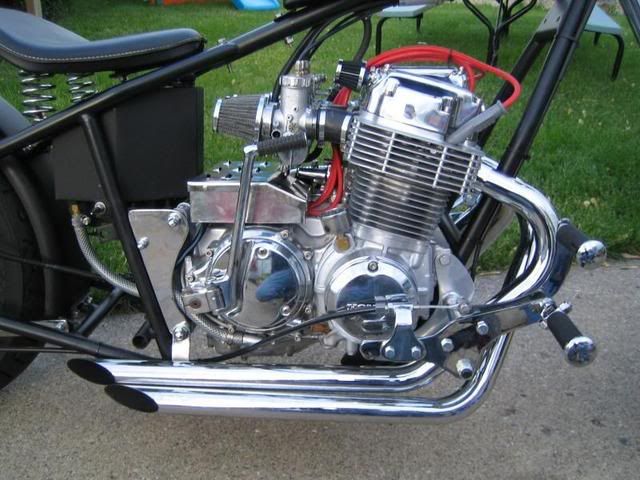

Damn! I can't open the pic (stupid Army computer!) so I can't see why you don't want to mount it in the usual spot? I saw a Lockhart cooler mounted between the headlight and front fender in my "Great Bikes of the 70's" book, it looked pretty, er, cool! ;D
Offline roadkill savior
  • Posts: 57
    • Hondachopper
Re: oil cooler under motor
« Reply #378 on: May 29, 2008, 08:26:44 PM »
The Harley ones aren't wide enough for a Honda 4 frame.
The space between the air filters and oil tank is less than an inch.
If I put it underneath I could put a skid plate over it to protect it.
 The question I still have is concerning oil flow.........I'm almost positive that the oil pump has to be the lowest point on these bikes. Anybody know for sure?
I just bought a Lockhart that hangs vertical instead of the normal horizontal style and it's only 3 inches wide so maybe I can fit it in between the 2 center exhaust pipes.

If the oil cooler is placed inline with the pump output (like where the oil filter is) and the lines don't restrict the flow, then the pressure will keep the oil flowing.  Are you going to use a temperature controlled bypass to prevent over-cooling the oil and causing oiling issues?

What I forgot to mention is that the dyna coils are going to be mounted under the neck where they can stay cool, but I'm now thinking of mounting a cooler there the thing is the coolers I have so far (3) would look #$%*ty there. A small Lockhart would work great but I'm running out of time and can't find one......I've been biding on ebay but they are going for too much. ;D
 I powdercoated the entire motor and I am hoping to compensate by adding a cooler.

Mate you've got enough room for both a cooler and your coils, but seriously, why not run an electrics box under your carbs like all the Honda 750 chopper guys did back in the day?
I've got one under my bench, it's just a vented box with brackets for your battery, coils, regulator/rectifier etc?
It keeps all your electrics tidy, you can get it chromed and it accentuates the look! Cheers, Terry. ;D

I do run a Santee box under the carbs......
But the coils were getting too hot under there...so I sacrificed fit for function.......
actually only the old Finch boxes ran the coils in them and they were very tight
The rest mounted under the neck in a chrome "cow bell" box.

Yep, I can see that mate, and you're right, putting the coils (or an oil cooler) behind the engine isn't a good idea, as all it's gonna get is hot air off the engine. You might have to continue with your "Function over form" initiative and run the cooler and the coils out there in the cool air. Cheers, Terry. ;D

I think your right Terry........thanks to everyone for all the suggestions.
